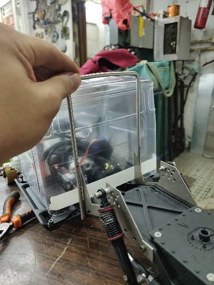

For the body I trimmed down the fenders slightly and cut off the side step which allowed me to lower the body a bit further.
I decided to do some simple cage work in the back to finish it off. This also acted as the rear body mounts and shock mount since the original shock mounts didn't really fit offered no adjustability. The cage is made of a mixture of 3/16", 5/32", and 1/8" solid stainless rod and some 0.8mm stainless sheet. Ideally I would have preferred to use tube so it could be lighter but I didn't have it on hand. The spot weld are plenty strong but it doesn't look as good unfortunately, would like to work with a tig some day.
The front bumper + brush bar was made of 1/8" stainless plate and some 3/16" rod, this part I did have to stick weld together it was pretty messy, but it cleaned up with an angle grinder just fine.
All the cage work and bumpers are just bolted on btw, so if changing it down the line is pretty simple and straight forward.
The bit where the cage mounts to the body was also reinforced with some 0.8mm sheet to stop the lexan from ripping.
