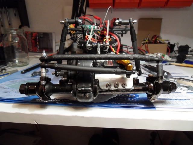

The stard of the build...
And this is how it stands at the moment:
Since this is my first build I went with delrin links. Like this I'm sure they are the same lenght :flipoff:
The upper rear links would be better on the outside of the chassi but I get interference with the lower links...
I will run it as it is and, probably, change the links in the future 8)
