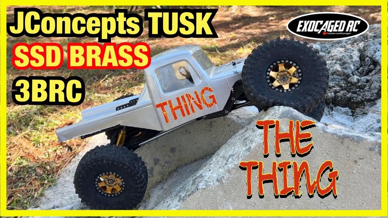

I was planning to buy an Element Enduro V2 kit for my next build. However I was watching Exocaged on YT and saw how impressive his cheap carbon fiber frame and tranny build is going.
Now I am thinking of doing the same thing.
I think it is interesting how he used a straight axle in the front and a portal in the rear. Would this not lead to a major difference in gearing?
What do you guys think of this over the Element for a serious dedicated crawler?
I will probably just build it for now with a set of TRX4 portals, a WP1080, and a Holmes Crawlmaster.

Element does just fine as a dedicated crawler.
Portal axle in the rear is on purpose. Overdrive to the front, basically having dig without having dig. Much like how the element stealth transmission works, the front wheels spin faster than the rear, helps it pull up over obstacles and such. I've seen builds using the element transmission and portal rear axle for that reason. Works pretty slick.

Yep under driving the rear is beneficial for sure. Just didn't know if the difference between a portal and standard axle would be too extreme.
Also the carbon frame rail set he used has a very forward placed transmission. Wonder if this is better or worse then a centrally located tranny?
