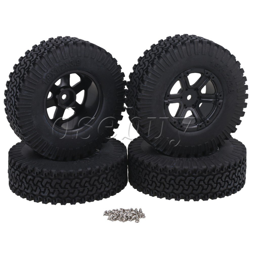

In addition to the cheap tires mounted to aluminum beadlocks that I have pictured above, I brought a second even cheaper setup with me that just arrived recently. With the tire setup pictured above, grip was pretty poor. It did ok going up larger smooth rocks, but trying to climb through the smaller rocks between lanes, and especially in the sandy, miscellaneous material in the drainage ditches, these tires really struggled.
After a while I popped the cheap ebay wheels/tires on. These are a glue-on style wheel, but the tires aren't glued on. Even like that, these tires surprised me. Performance on large smooth rocks was pretty much the same as the other tires, but over the smaller rocks and in the looser stuff, these tires were fantastic. You could hear the tires gripping the rocks as it crawled lines that the other tires couldn't do without a bunch of wheel speed. The only time I ran into trouble was when they got bound up, and then the tires would slip on the wheels. Honestly, with plastic lockers and no slipper cutch, that's not really a bad thing.
cheap ebay wheels:
I also really like that these wheels have a shallower offset, so the tires tuck in closer to the body. Now I want to find a nice cheap aluminum beadlock with a shallow offset to mount these to!
