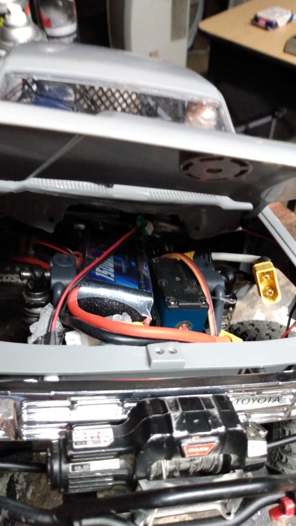

I am not hating on Enduro at all. This is my C1 Enduro build with Axial Ar44s and TRX shocks. I have to move the winch back into the body, it is in the way, my place isn't picky on interior but man places my butchered interior with wires running though it wouldn't pass. And no room for the stupid flipping 3d engine cover. Where I comp I score in the low 50s. If they were pick my score would be lower because of my interior.
interior:
no room for 3d motor and no separate tcase:
Winch too far out front:
I love how it drives but
