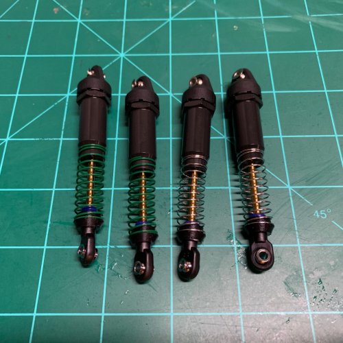

I’ve had really great luck with Traxxas shocks for the TRX-4. Well made, use x-rings rather than o-rings (never had any problems with leaks), and have a variety of spring sets. There are decent deals on eBay, probably from kitted out trucks. Here’s one example, I’ve seen them for $5-10 less from other sellers
https://www.ebay.com/itm/Traxxas-TR...829849&hash=item285e4a93f6:g:sUMAAOSw~jpbMVQX
I think the big bores are nominally for the Slash. I used the plastic-bodied version on a v1 SCX10 and was really happy with the performance. The aluminum bodied versions and only slightly more - probably the better buy, but I didn’t understand this at the time.
Good luck with the mods! It’s a great platform and has been a lot of fun for us.
