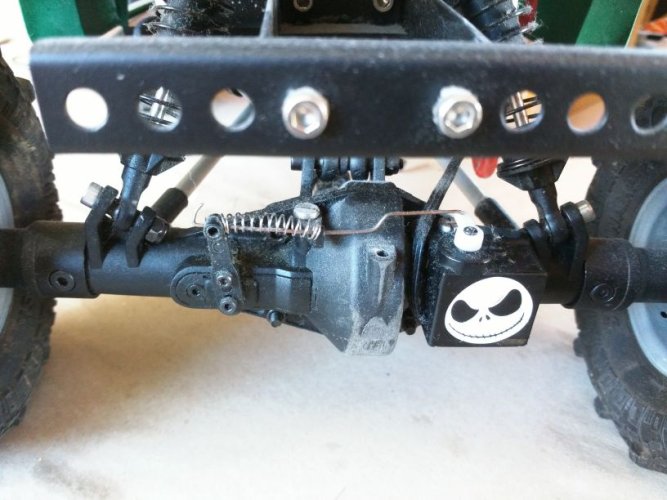

I don`t know the post you are looking for, but this is what I came up with for the locking diff:
i know the post you are talking about, i used the idea for myself. i just got a larger piece of plate, marked out the mounting holes and bent a side up vertical on the left hand side of the front servo. double sided tape a micro servo to it with the servo horn sticking below the servo plate and put a small rod across to the diff lock lever. then you just need a 3 channel radio with adjustable end points
