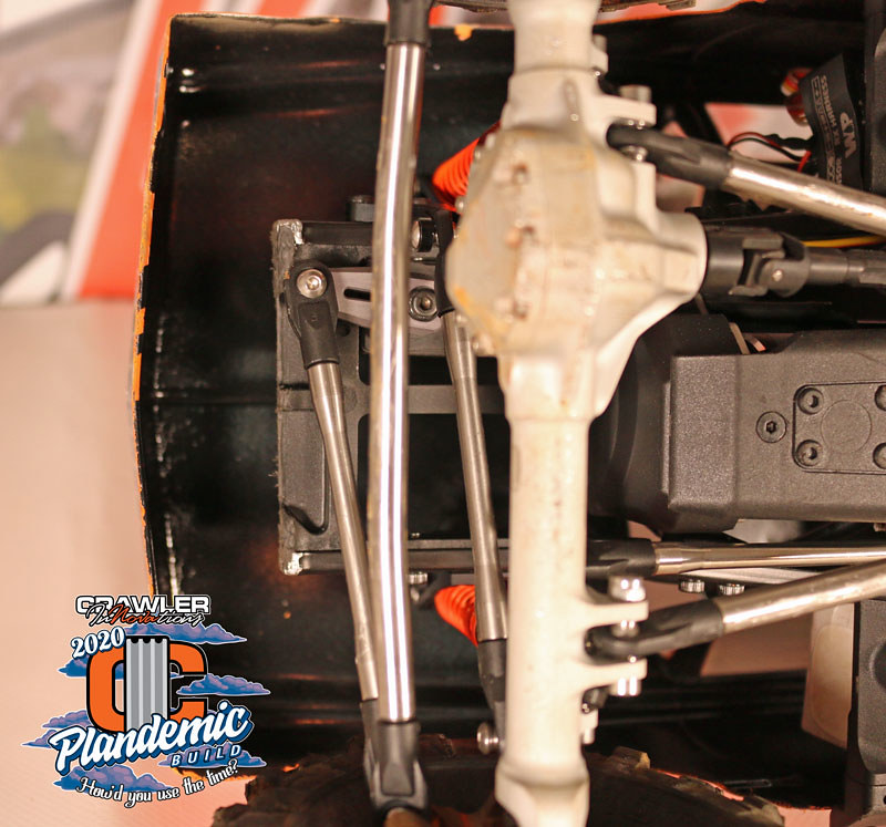

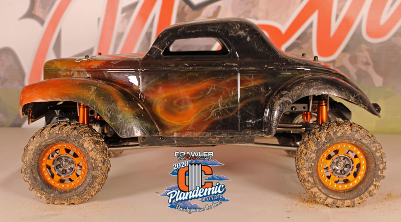

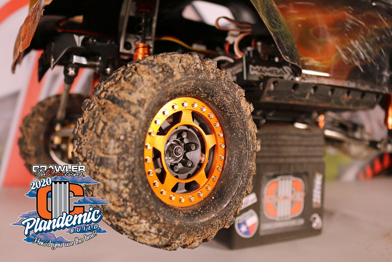

So the plandemic hit everyone and for myself I continued the hermit lifestyle and used the opportunity to create some new builds in 2020. I pieced together a short wheel base VP build and was so impressed with how it performed that I decided to piece together a second truck with a longer wheel base. The C10 is the longer wheel base and the second truck built this year.
C10 Specs;
12.25" WB or 312mm
VS4-10 chassis
VFD transmission
OD trans gears
Extended VP shock towers
VP drive train
Mamba X
1900KV Castle
Hitec HSB-9485SH SERVO
Castle BEC
Futaba TX & RX
4S lipo
Hot racing brass knuckles
VP rear brass rings
Dlux orange shocks
2.2 VP bead locks w/ custom rings
1.9 Pitbull XOR tires
CWR-2017 front Lil Nova Foams
CWR-2317 rear Lil Nova Foams
C10 Specs;
12.25" WB or 312mm
VS4-10 chassis
VFD transmission
OD trans gears
VP drive train
Mamba X
1900KV Castle
Castle BEC
Futaba TX & RX
4S lipo
VP rear brass rings
Dlux orange shocks
