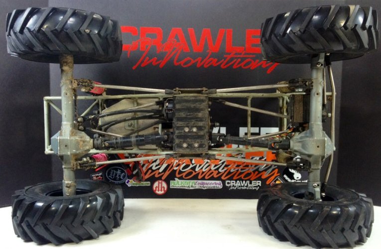

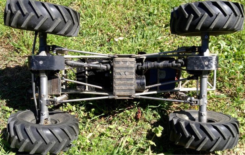

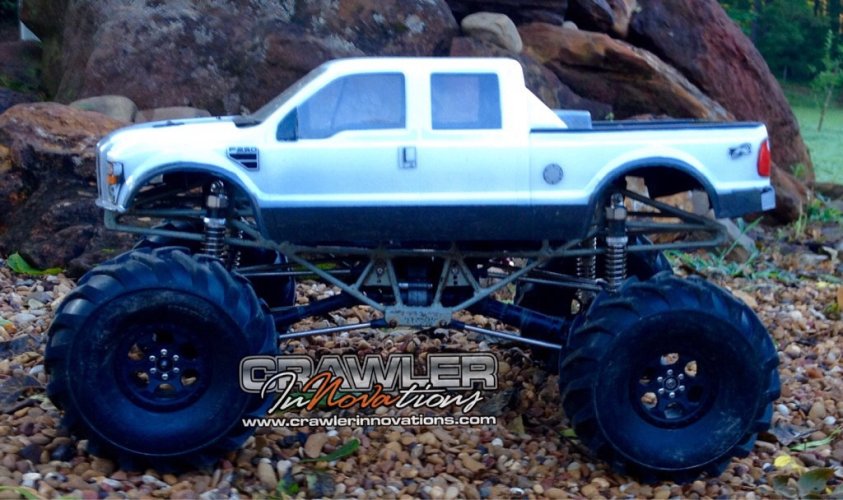

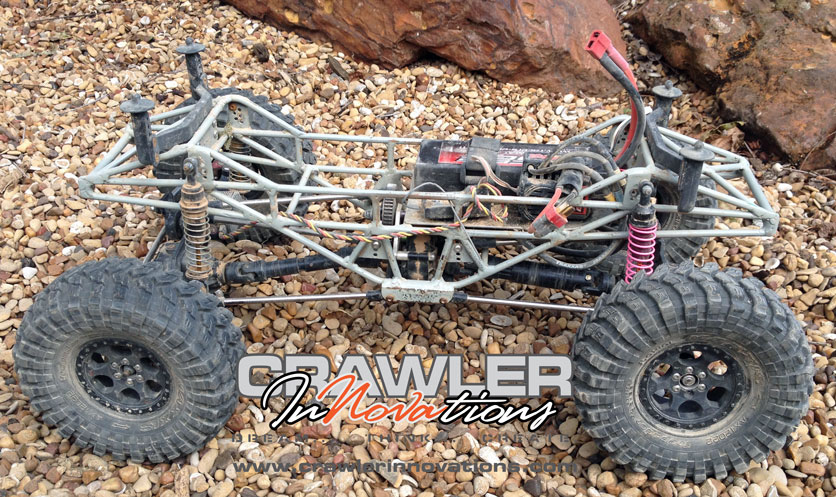

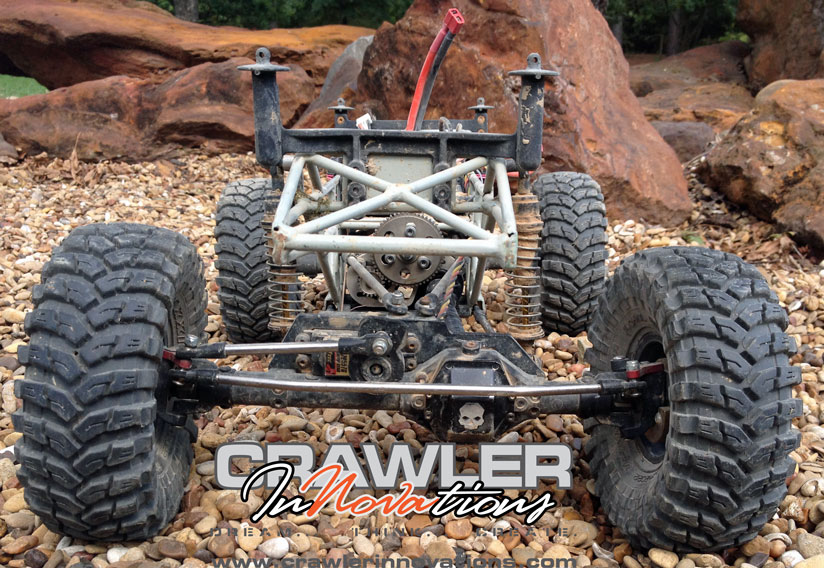

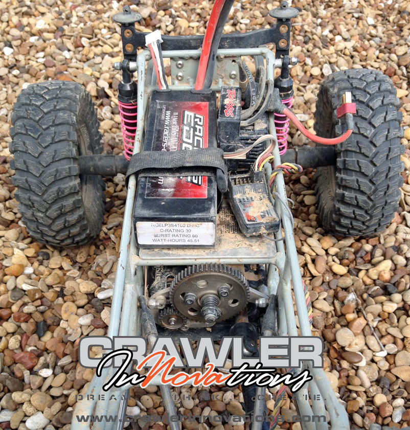

Here is the most recent solid axle AR60 MT at the CI garage. It's due for a rebuild, so now is a perfect time to start a build thread for it. Chassis design and construction credit belong to ROOTAR here on RCC"thumbsup". He does outstanding work. The chassis is 3/16" tube and tig welded. It's extremely light and strong. ROOTAR put it through several skate park sessions before it made it's way to the CI garage.

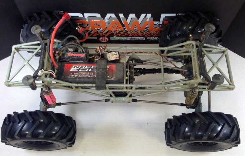

Current Specs as pictured:
Axial AR60's F/R
OPEN DIFFS F/R
UD HD Gears F/R
Brass bushings on pinion
Uni's Front
Hulksta Engineering 5mm Ti Rear shafts
RC4WD Covers
CI 6 Bolt Wheels
CI Deuce's Wild 2.2 Standard Foams
2.2 R35 Trepadors
Lunsford Ti Links
Traxxas 3.5" Shocks
Dinky RC AR60 Trusses F/R
SCX Trans
RRP Steel Gears
CI 6mm Outputs
BWD Motor Plate
Revo Drive shaft rear
Custom Maxx Shaft front
17.5 Sensored LRP motor
Traxxas ETS3 ESC
3S Lipo 4100mah 30C
Hitec 7955 servo
OverKill RC GT3B & RX
kimbrough servo saver
RRP Steel 32 Modded Steel Spur

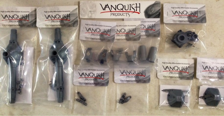

Without sponsors, many of these builds would not be possible. VP is one of the best and so is their products:

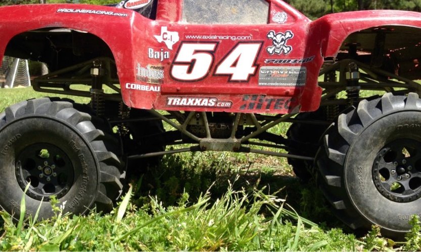

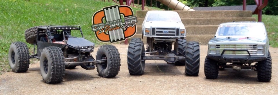

The fall weather is wonderful this time of year in East Texas. One of the local parks had a big pile of wood chips sitting out for park upgrades. CI took advantage of the opportunity to play with the FOFF truck and the AR60 axled Monster Truck. Mr CI drove the FOFF truck while Mrs. CI drove the Monster Truck.
Both vehicles are using heavily modified drive train parts, use sensored brushless motors, 3S lipo batteries (12volts), and Crawler Innovations Deuce's Wild Foams.
The FOFF truck is using a proto type set of Deuce's Wild Single Stage Foams that are designed to fit and stretch 2.2 Paddle tires & 1:10 buggy rear tires. The brand of tires are Panther.
The monster truck is using Crawler Innovations 6 Bolt Wheels, Deuce's Wild 2.2 Standard Foams, & Axial R35 compound Maxxis Trepadors.

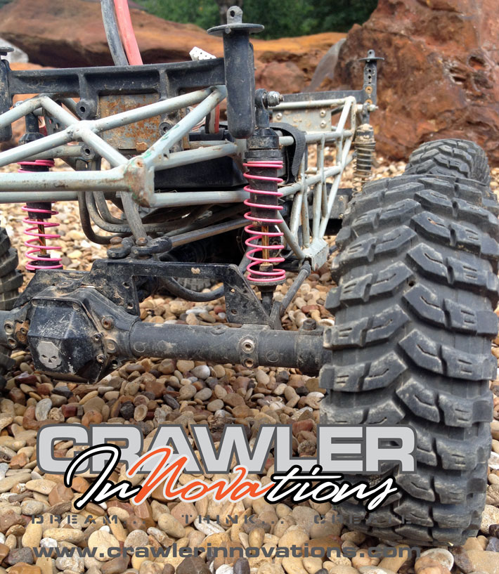

I own a second AR60 based Monster Truck that I am yet to rebuild and start a build thread on. Szczerba built the frame and his build thread is linked below. Szczerba modified clod wheels for SLW hubs. They look cool8) but don't hold up to abuse:cry:. The Axial AR60 axles are truly tiny and a joke. They take complete over haul with full upgrades from other manufacturers to hold up for more than a few minutes of use. I have been switching over to Kyosho Twin Force axles more and more for anything that I want to last and be truly durable.

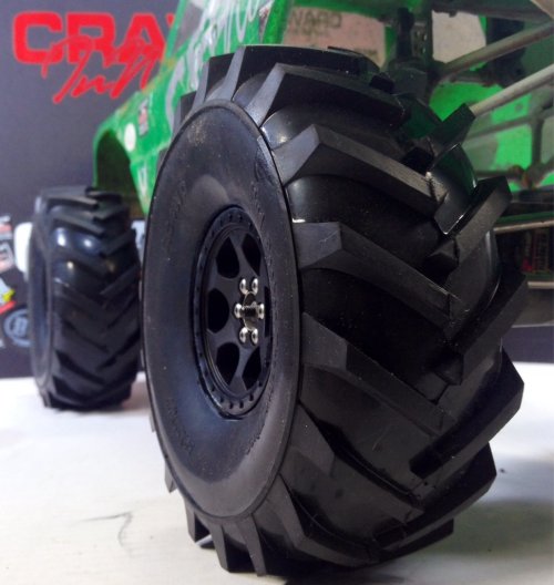

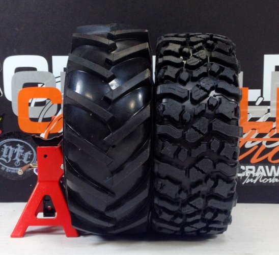

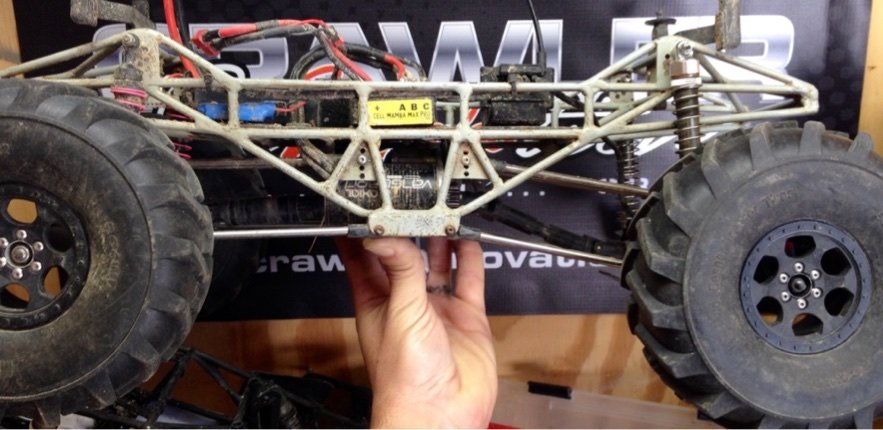

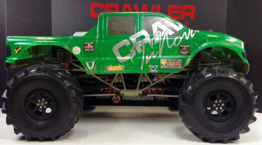

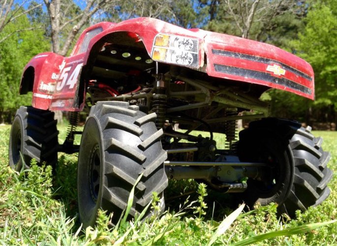

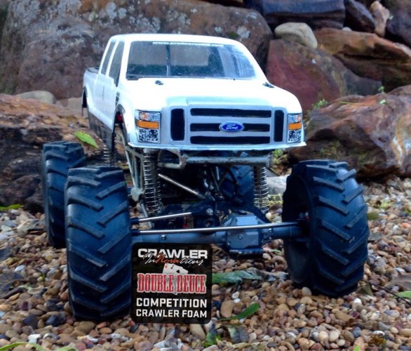

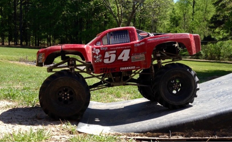

I finished the rebuild if this truck back in October but failed to post an update. With the release of the RC4WD 2.2 Mud Basher tires, it was time to post an update on this truck.

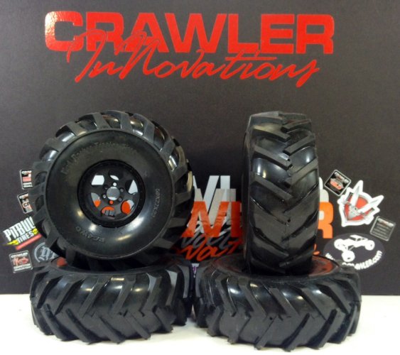

RC4WD 2.2 Mud Basher Tires
Deuce's Wild 2.2 Standard with a 5.5 Firm outer wrapped around it, plus a 4.50" Tuning Disc in the outside
CI 6 Bolt 1.50" Wide rim / wheel
Compared to a Pitbull rock beast 2 on a 1.50" 6 Bolt
Installed on the truck:

Thank you sir.
I don't think the AR60's would hold up to a TTC event. These big tires eat HD UD ring and pinions, especially if the axle is locked. As long as the axle is open, they last pretty good.

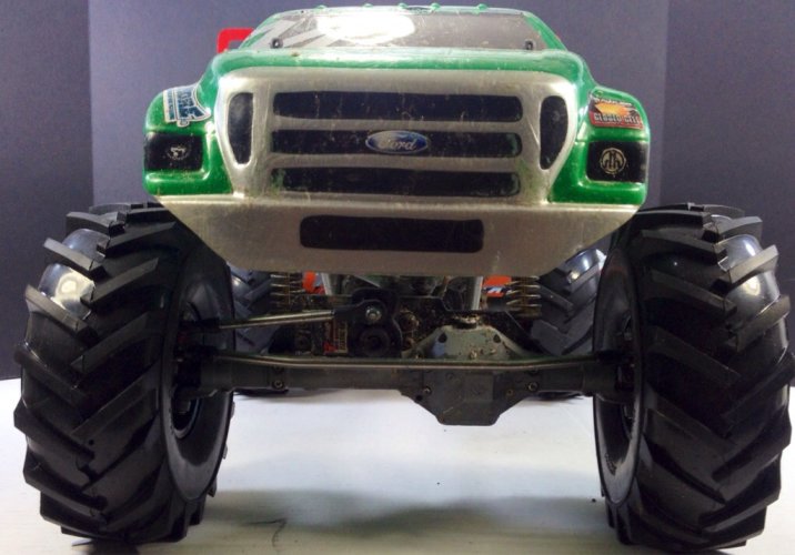

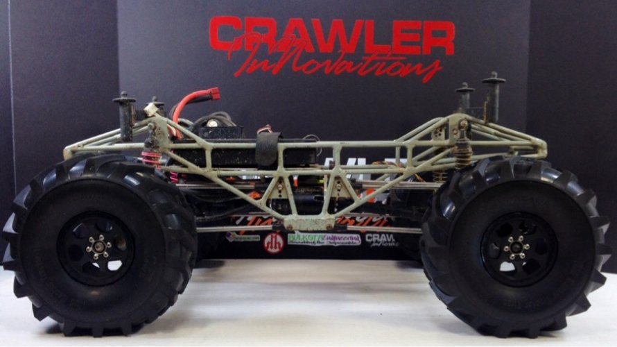

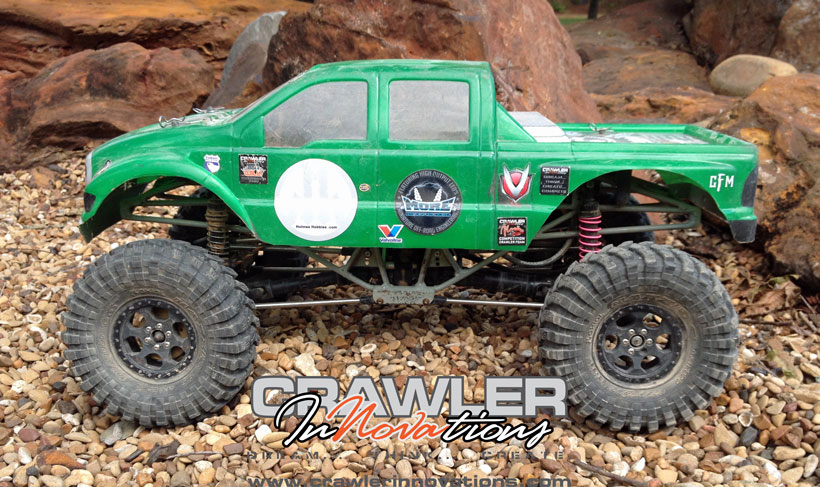

It's been six months since an update. This truck has been put through so much the last 6 months. The 17.5 Reedy motor finally lost the front bearing three months ago and was replaced with an axial yeti motor. The Traxxas et3s esc has been replaced with a Castle MMP 1 Cell & Castle BEC so more voltage can be run efficiently. The 3.5" big bores were swapped out to 4" shocks for more suspension travel on big landings.
The green ford body got trashed and was temporarily replaced with a short course body.

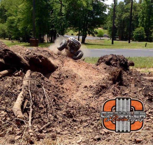

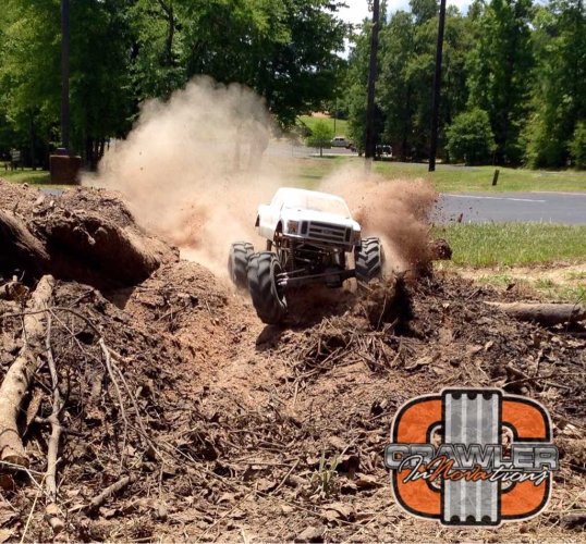

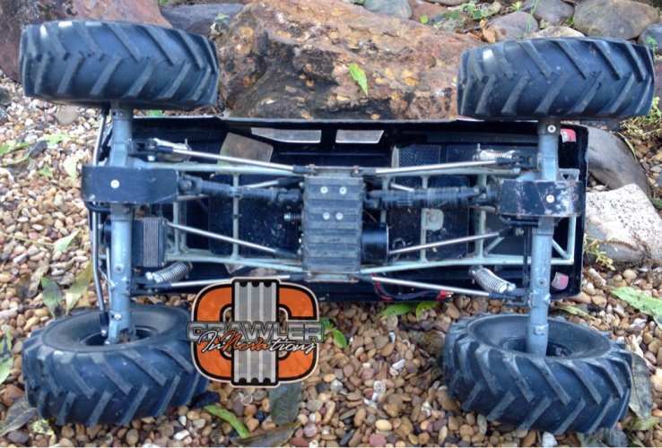

We went to a local park today to test, tune and film. Here are a few photos from today's outing where we found a burned out stump full of ash that made for some photo fun.
..Uploaded from the lab @ the C.I. Compound...
