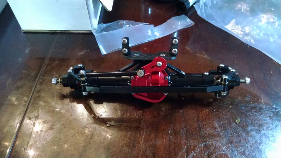

Here are some pictures of the axle prior to installation.
