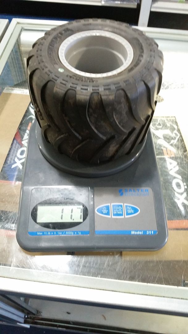

They're not bad, no worse than the Maxx tires and RPM Rims I had on it before. I can take my stretched Wheely King to work tomorrow to see what the weight of that combo is, they do have some great grip for what little I've driven the truck.
If you can do that for me I'll greatly appreciate it!
Ok, I've got today off, but will be stopping by work to get some stuff for my Vaterra, I can borrow the scale while there.
