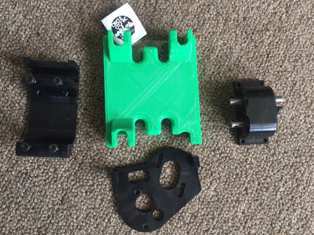

I like a scale hardbody with interior. So originally I bought GCM forward motor mount and had Circle City RC print me a custom flat skid. Assembled the kit and immediately knew this wasn't gonna work. The motor is so high and it hit the interior of my tf2 body. So I sold it all. But I would recommend Circle City skids to anyone. Link risers built in. Smooth also. Fast turnaround.

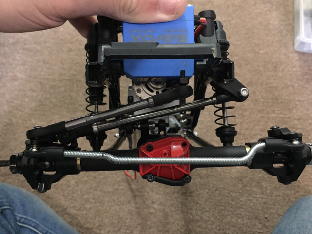

By this time I had already purchased a front axle from Ernie. But decided I wanted to narrow it. This is customer service at its finest. He let me ship the housing back and he got me one narrowed 4mm on each side without costing me anything extra. To narrow 8mm I did have to cut some off the universals so they don't touch in the middle. But there is more than enough left where they won't spin off. Sorry for the lack of pics here.

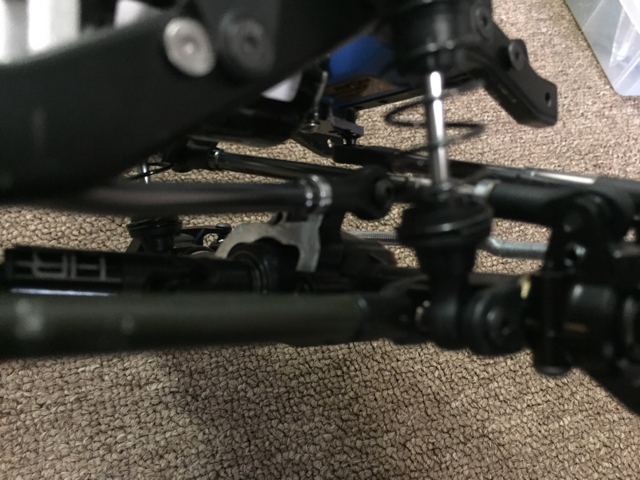

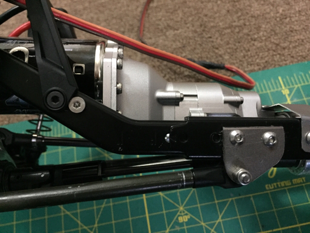

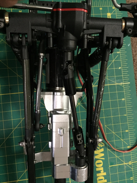

I knew I wanted to use these axles so I almost bought a GCM cmax chassis but didn't wanna drop another $200 into it I decided to make the ascender chassis work with the Rc4wd r4 trans I had from my tf2 part. The mount is the Rc4wd motor mount. I cut about 2mm off each side and it fits right in the frame rails. I originally mounted in the back shock tower holes but the front upper link mount would hit my motor. So I slid it back a couple mm to just clear.
The silver bolt is the trans mount.
I tried to keep the double servo mount for a winch but I couldn't get it to fit with the motor so swb servo it was.
My lower link mounts are now on the frame rails close to where the skit mounted them on the 290 wb. Since I'm running a 11.3 body and the motor limited what links I could run I found this to be best. My lower links are 68mm. This puts the shock almost touching the panhard mount at full compression.
I had to use an strc aluminum front mount trimmed to clear the motor.
The rest was just lining up everything to make sure it clears.

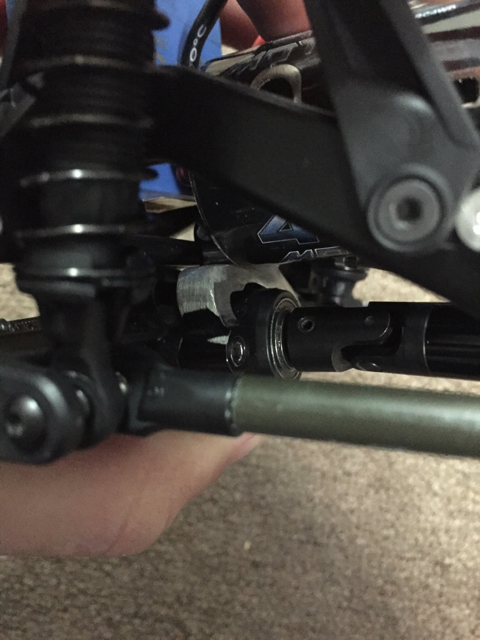

I had to use this driveshaft to clear the trans during compression. It's a scx10 shaft. I put the vanquish adapters in my axles.

Dig the steering link for sure. How did you bend it?
It's just 8/32" all thread. It'll bend with vise grips and your thumb. It's only for mock up.

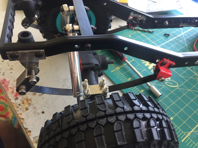

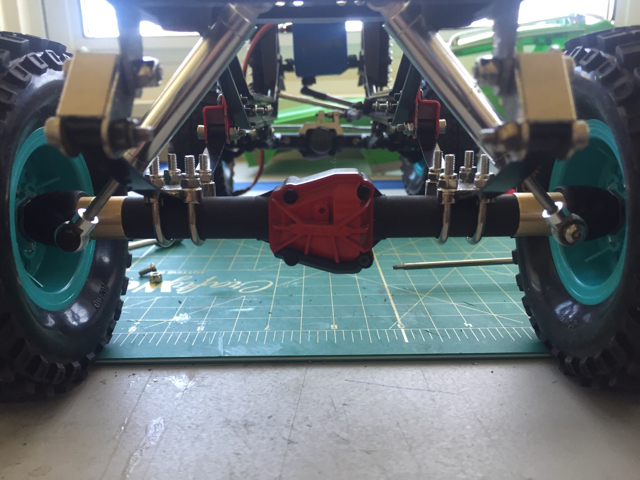

I got the axle housing for the rear from Ernie today. Thanks for the fast shipping!
I mocked everything up. Works perfect. Here is my leaf set up without spending a ton at GCM and without all the extra brackets. I cut the shock and link mounts off. Used gmade ubolts. My axles are narrowed 4mm per side. That's why the shock mount is so close to the tire. Shocks are 90mm

Nice job engineering Cameron. I think the brass tubes inside the axle should keep your u-bolts from collapsing the axle housing. Keep up the out of the box thinking! "thumbsup"

I did this with a set of ssd d60 axles last year. Just like you said you can collapse the plastic. I knew I'd need brass inside. Thanks for the help with everything.

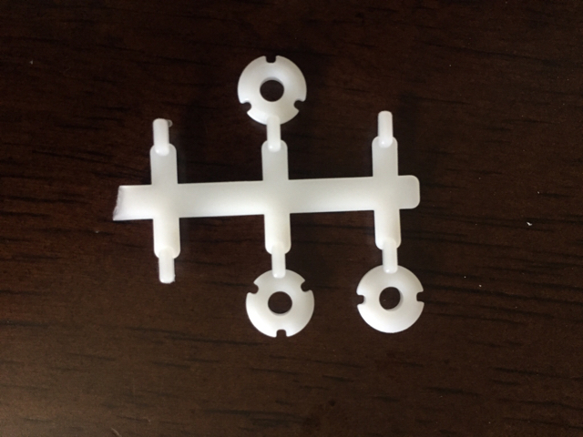

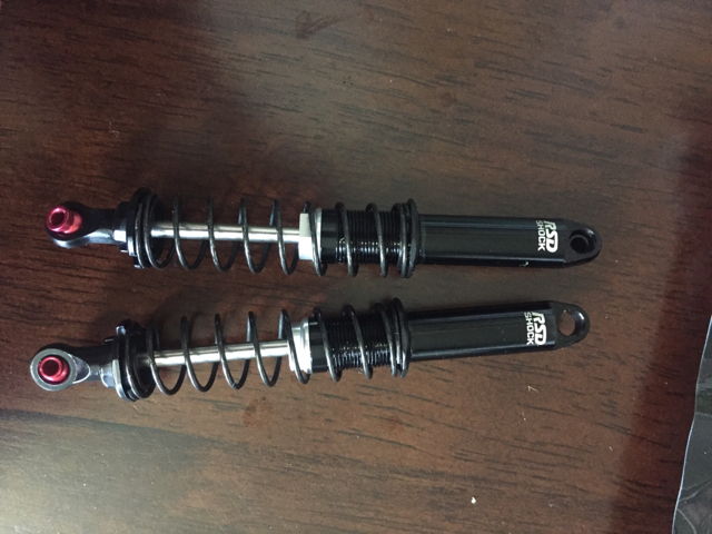

I bought a set of 100mm Gmade RSD shocks to try on the front. I don't think people try a lot of their product because it's not carried by a lot of people in the US. But it's really underrated.
They give you 3 sets of pistons to tune. I opted to try the 4 slots to start. By feel I would start with the 3 next time but I'll try these for now.

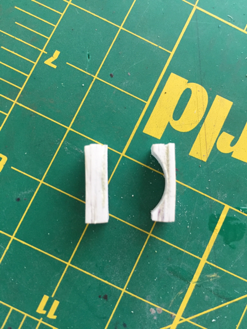

So last year when I made a ssd d60 housing a rear leaf I just drilled the housing like I did this one and used gmade perches. But instantly found the leaf would wrap on the round axle. So I copied the sawback axle and made a perch mount. Worked perfect. So I did the same here. Simply stacked styrene and hit it with a round sand drum on the dremel. Then just glued them on. You can change the pinion angle just by sanding the top layer.

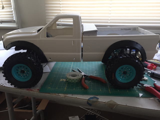

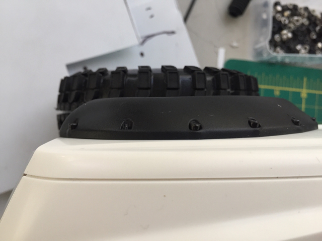

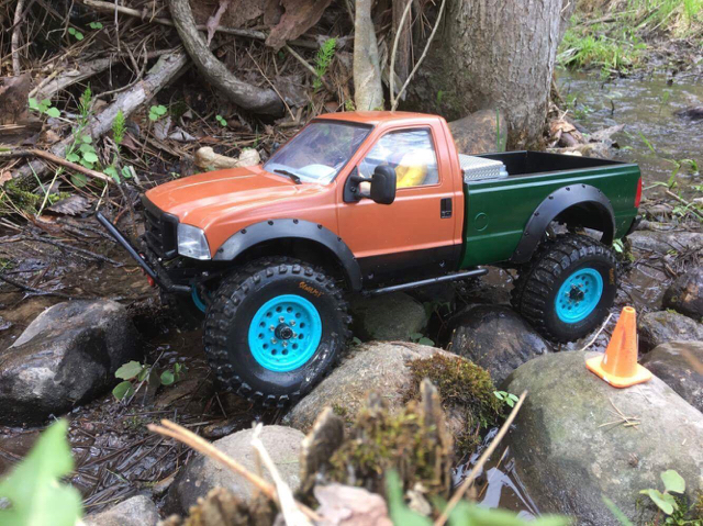

Here is a mock up shot of the body. With the 8mm narrow and flares I just get enough for class 1 coverage. I also started a drop bed to meet sorrca rules as the stock body isn't enough for drop bed points.

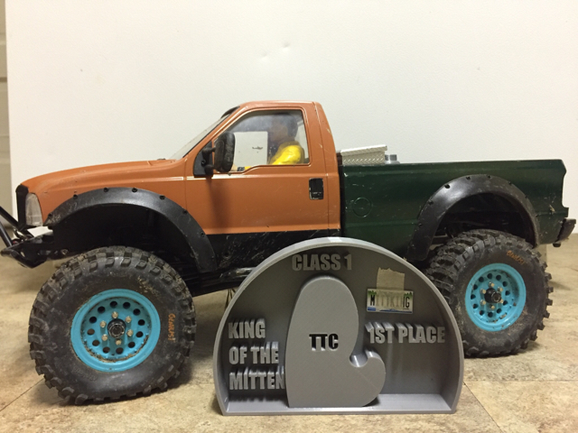

I've been bad at pics but I took this to its first comp. Was also the first run. Nothing broke. This truck just works.
Hey Cameron, great job!!! It must feel good that you stepped out of the box on this build and it really did work. A pat on the back to you. Are you able to utilize all of the steering you gained with my axle set up? I really did enjoy working with you to figure them out. Are you using the new shocks on the truck, and how do you like?
Keep up the good work."thumbsup"
Ernie
Wow Cameron after watching that truck perform yesterday I think you have me convinced on ditching all my scx10ii axles and doing the codyboy mod. Congrats on that first place Win. and hope to see you do it all over again next weekend at Richfield."thumbsup"

I can almost use all the steering. Being narrowed does cut me a little short because my tires hit the links. But well worth the money. I did use the gmade shocks. A bit disappointed. They leaked sitting on my bench. I'm going to rebuild them but with the 3 hole piston instead of the 4. They worked well paired with the leafs in the rear.

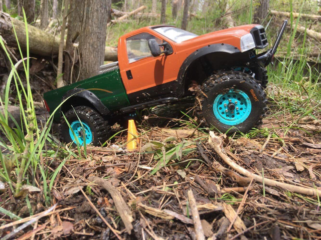

Here are some pics from the comp. I have a couple things to tidy up. Raise the front bumper. Finish the interior. Stickers. [emoji23]
