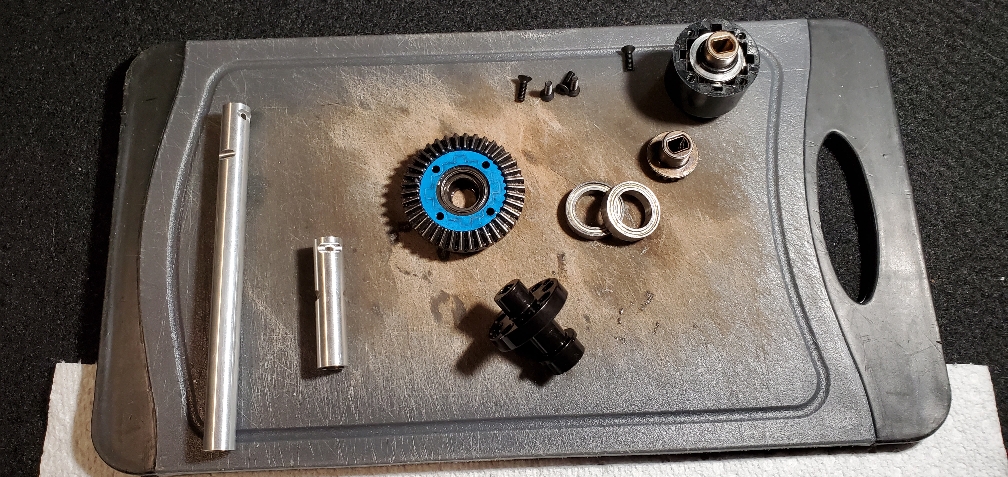

Small update not sure what to make of it yet but I'll post pictures and such. Decided to clean the diffs up and see what might have caused the center diff to fail. What I found was this.
Center diff did have 2 shims but was missing an o ring and one of the shims has a serious lip to it as well and is bent towards the middle. I assume that the bending was caused by the lack of the o ring. The lip was on the gear end and it's was bent away from the gear towards the case. Also noted that the rear diff main gears are a different color too not sure if this was anodizing or from the hardening process. The gear that is almost silver took the most damage and the other has a slightly dark color took less damage. The rear diff had no noticeable wear at all.

Well I'll probably lock it anyways but was mostly curious as to why the mass failures. Bottom line I believe that Axial made a mistake in the tolerances on the diff cup. I have 5 stock .3mm shims in the diff right now and it still spins freely. Granted i have no play now other than the little bit that the o-rings allow which in my opinion is perfect tolerances. Still 5 .3mm shims that is what 1.5mm that pretty far off on the tolerances as far as I'm concerned. The teeth of these diff gears are barely 1 to 1.1 mm deep so that much slop its a wonder they even engage at all. I'll post a picture or two showing that 5 shims barely clears the top of the diff cup but when you add the diff gasket you really could stand to add another .1 to .2 shim to take up the tiny bit of movement that the gasket allows. There is no reason that the tolerances should be that far off and whats worse is that as the o-rings degrade over time each 0-ring is 1mm thick so lose one of those your screwed..........seems like the ball was completely dropped here.
Sent from my SM-G975U using Tapatalk
Not sure how well you can see in the pics but that's 5 shims in order to get it adjusted correctly. I put the ring gear back on and tightened it down and the diff spins smoothly. I took a file to the old center gears that were shot and they seem pretty hard so probably if shimmed properly they will hold up well.
