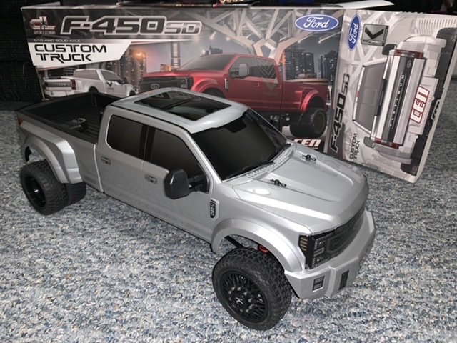

Okay, I just want to start this off by stating that even with the rough start to this journey, I still love the truck and it will be a blast to get it where I want it to be.
Upon unboxing the truck and removing the green protective film, there was a significant scratch on the hood of the tru. It looks like who, or what ever machine installed the body pins, it scratched the hood.

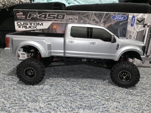

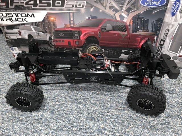

EDIT - Some teasers :twisted: This is just with the body mounts jacked up. Funny thing, you can raise the front way higher than the rear. That one makes no sense.
This one, was from the beginning, after disassembling all the cross members and transmission mount.

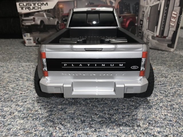

And of course, once I got moving, I forgot to stop for pics along the way…

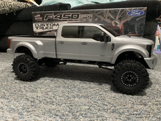

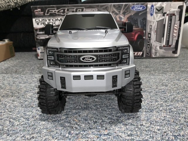

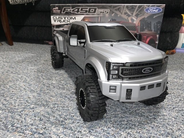

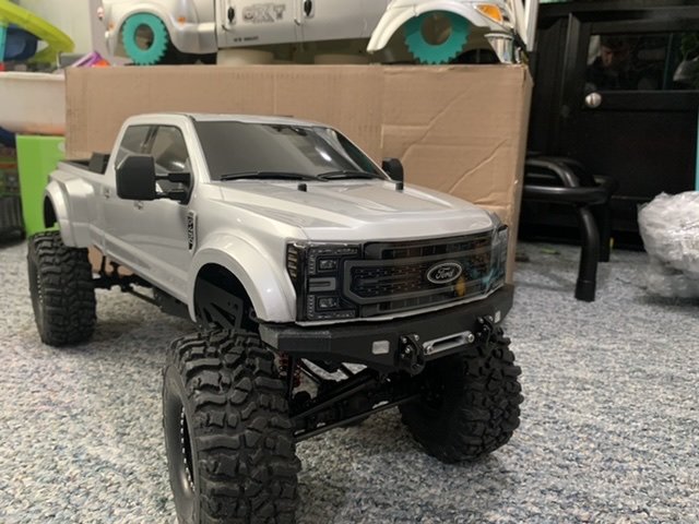

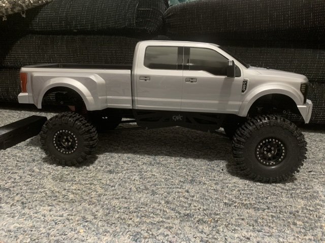

Okay, here are a few of how it currently sits. With the 4.88” tire diameter, I’d like to get the body down a little, but the rear is about as low as it can go.
This is just one step along the way, so don’t be too harsh…

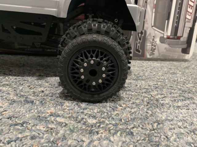

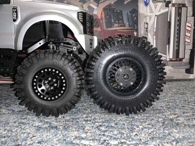

Stock tire against the 4.88” 2.2 Mud Slingers
5.7” 2.2 Tall Skinny Bogger next to the 4.88” 2.2 Mud Slingers

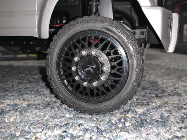

Well, I couldn’t wait to at least trying one of the tall skinny Boggers on to the cheap 2.2 beadlock wheels.
The kind of have that funny bulge on these wheels too.
I think they actually need a little wider foams and they would fill out a little bit better.

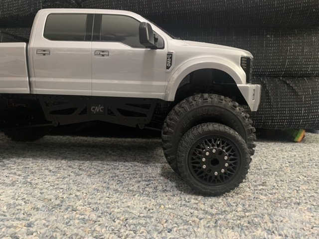

So, as I stated in my thread up in the Tires and Wheels section, I think I have figured out that I had a set of tires already here that look decent mounted up on the cheap 2.2 beadlock’s. I will likely black out the 6-Lug’s, as it drives me nutz having 6-Lugs on a Super Duty…:lmao:
Here is the stock tire against the Pit Bull Rock Beast II’s

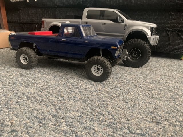

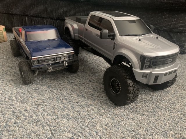

Here she is sitting next to my droop Gen8 AXE F150.
