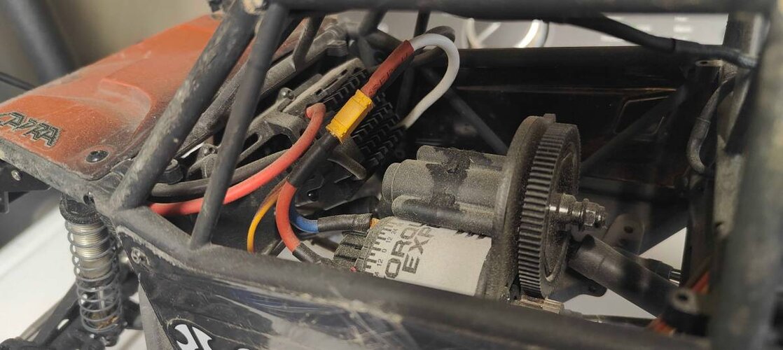

I cheated. I replaced the skid with a Salinas Designs (no longer around, Vader is the closest to it now) and ran an Element X transmission - Which had a build in Overdrive/Underdrive which could be changed. I chose to overdrive front, underdrive rear. The Element X trans does not have Dig.
I have have an original capra transmission with a 10t pinion running straight axles using a Hobbywing Fusion SE 1200kv and is very slow and controlled with enough speed to jump ledges. Stock servo. The SE is pretty affordable and likely cheaper than a skid and a different transmission set up and if you don't like it... well!!!! it can be moved to many other rigs (ESC and Motor combo).
