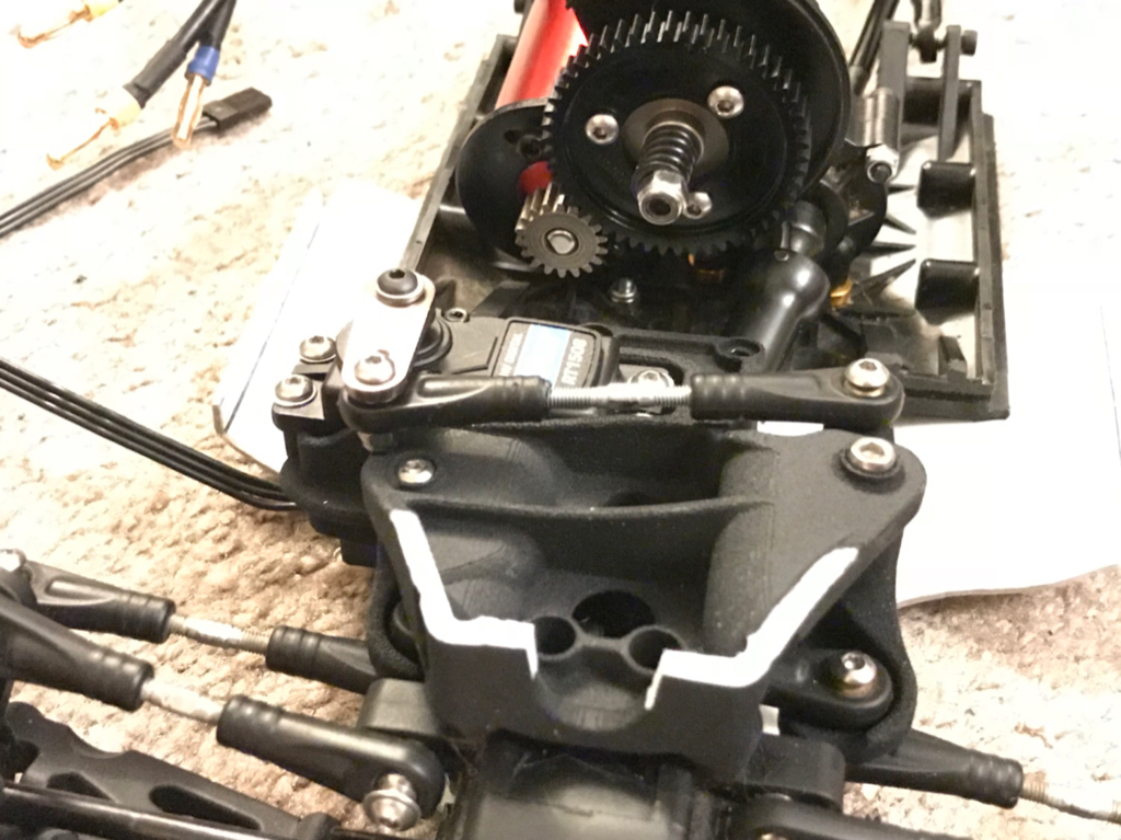

So the first stage was sort of a proof of concept. Get it to the wheel base of the body and see how everything looked and went together. I did have to get rid of the front electronics tray, bumper support and part of the rear end of the chassis to have clearance for everything. I also trimmed the front bumper so it was only the lower cross piece, but I still need to take a Dremel to it.

So the next step was to take the clear body and start getting it to were I wanted it to be. I trimmed the body so it was cut to how the rtr body was and then proceeded to cut out the front window and hood. Next was to mount the hood on the wraith cage so it would hinge. Do to my hands being to big to fit through enough of the body to put the battery in, I decide to mount it up front. Next came electronics trays on either side of the skid were the normal wraith interior mounts to, axial ae5 will go on drivers side and airtronics rx on passenger. After that I moved onto the battery mount. For that I took out the cross piece that sits behind the front shock tower and bent/trimmed a piece of aluminum to sit in there, which goes between the chassis and that cross piece to secure it. At the same time I drilled the cage and put holes near the grill to secure the hood down during runs.

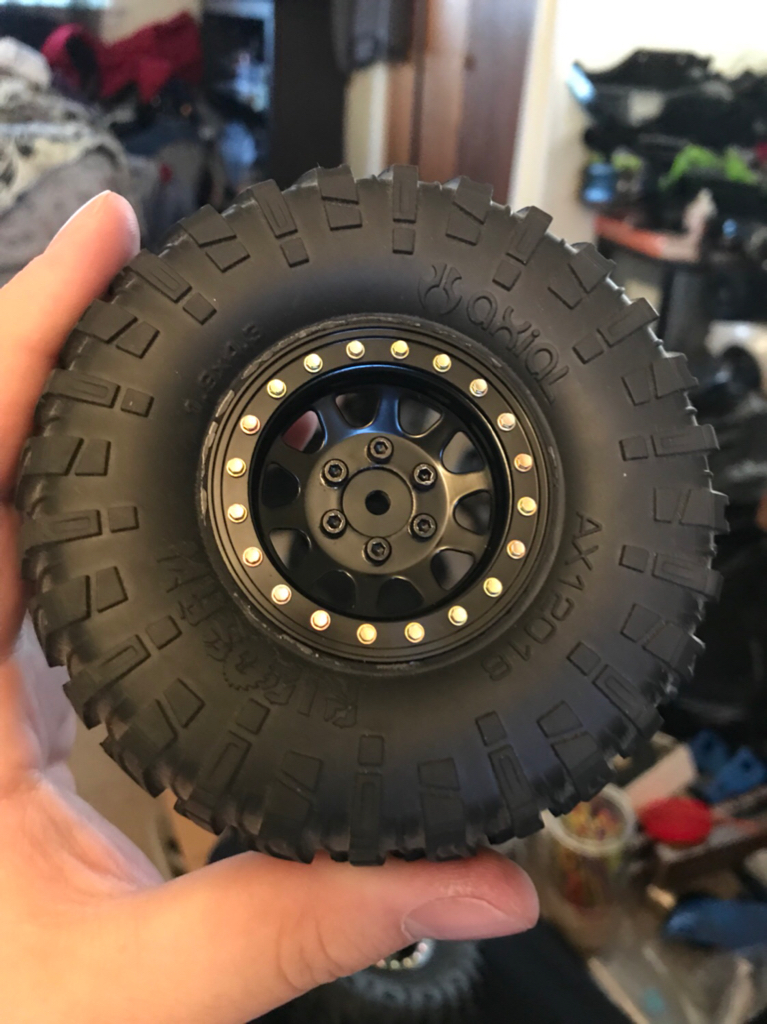

Other details not mentioned are the driveshafts are scx10 length mip but the front has a dig length male side. It's running a titan 12t motor with 18/87 gearing and will be run on 2s. It's also got the stock tactic tsx45 servo. Wheels and tires are ci 6 bolt 2.2 wheels with I believe proline kr2 tires with ci dual stage foams I think. They are cwr-1064 foams.
