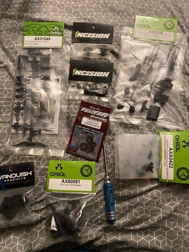

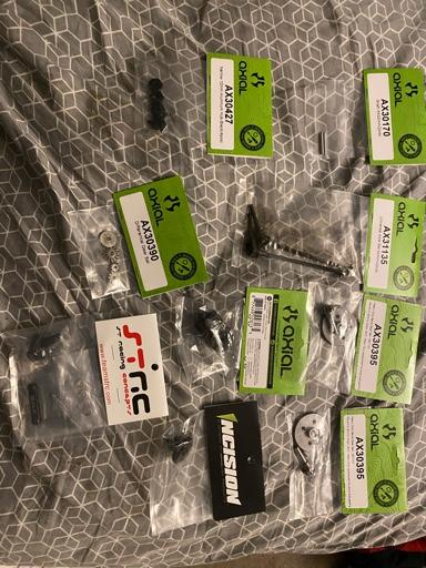

Ive received most of the parts that I’ve ordered so far, unfortunately I’m still waiting on more stuff!
A quick run through of what’s already here, I ordered all of the parts except the outdrives (how did I forget that) to rebuild the front diff as well as hd standard ratio gears. I am still waiting on the diff gasket as I will be running an open diff. For the rear axle I also picked up an incision locker.
For the rest of the front end I ordered a new bulkhead, toe block inserts (need toe blocks to), as well as yeti kit version turnbuckles to be able to make camber and toe adjustments. To finish off the front I also ordered an strc steering rack for the slash.
For the transmission I picked up a vanquish trans case, incision gears and outputs as well as fast eddy bearings.
I’ve also got a clear wraith body and way more of those annoying body mount screws than I will need, don’t worry I’ll loose most of them.
I’m still waiting on a super shafty motor plate, Robinson mod 1 spur (forget what tooth), locked up slipper eliminator and fast eddy bearings for the exo.
I got even more parts in only to realize the slipper eliminator wouldn’t work! So I ripped apart a stock transmission and stole the top shaft and idler gear shaft out of it and built up the transmission. Sorry I have not taken any pics.
I started to build the diffs only to realize I ordered the wrong ones!! Then after getting the part number, it seems like it’s been discontinued from everywhere because searching for the axial part on amain brings up arrma parts???? Anyways I was able to find it for sale on eBay so it’s on its way

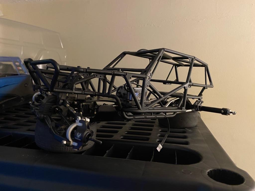

Anyways I finally got the ifs rebuilt and put on the wraith. It’s running a savox 2290 servo with a vp servo horn. I used one of the vp links that came with the ifs as the drag link going to a strc slash 2wd steering rack. The annoying thing about getting the strc rack is you still need to buy 2 plastic bushings from the stock rack. The entire front end is using all new bushings and I think it’s got 10k in the front diff. It’s also got brand new yeti cvds and axial adjustable turn buckles for camber and toe.
The rear links are incision bomber since I couldn’t find the vp titanium versions anymore.
This rig is close to being done, it needs center driveshafts, 540 motor (I have a pro4 hd but it doesn’t clear), wheels and tires.
