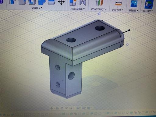

This truck will also be getting the rc4wd v8 and transmission with exclusive rc parts. I will also be chopping the hood off and designing my own parts in fusion360 once I get the hang of it. I have small 3D print build now in preparation of a custom build were the parts planning is nearly done, just need the skill
I realized the Rc4wd leaf spring mounts that I ordered are for the 1 piece axle ar44 axle housings. I am planning on using ssd ar44 axles so I’m curious if anyone knows if they will work or if there will be clearance issues?
I’ll be able to check myself later on today or tomorrow at the latest.
For those interested the rc4wd leafs that are for a 1 piece axle will not work on a multi piece axle. I checked an Ssd axle and no luck. So I will either design my own or find files on thingiverse or shapeways and print my own

I may have to move the axle mounts and shock mount down a few mm but here is v3 of the leaf mount
