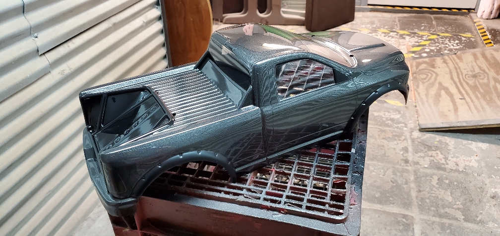

Painted the body tonight. It's been a long time since I painted a lexan body, but I think it turned out well.

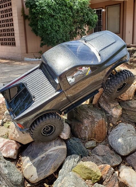

Just about done for now. I'm waiting on the rear axle spacers from SSD. My kit was missing them. When they get here I'll do a shakedown run & see what it needs, if anything. I'll do an interior & fender wells sometime this summer.

I tried to match the color of my 1:1. It's a little darker than the color this body turned out to be, but I'm happy with it. I've got a long, hot summer coming & plan on sitting in the a/c working on the interior rather than being out on the trails.
