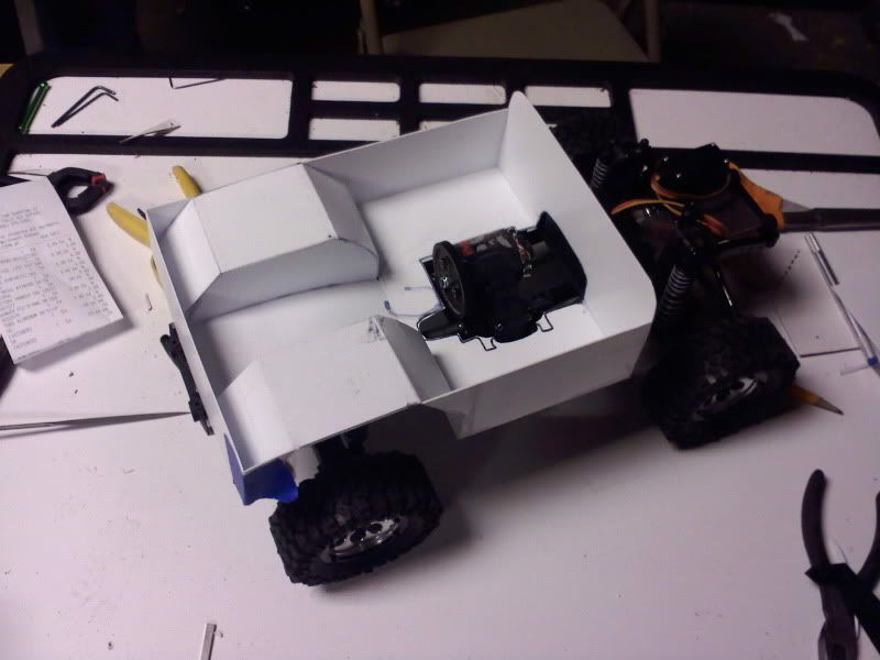

Started working on an interior, first time building with styrene.
Mocked it up with cardboard first to get the general shape.
Cut out the styrene and started gluing
Lots of test fits
Ran out of time so it's currently sitting like this waiting for the wheel wells to be bent over.
very cool bronco
hey mate im really likin your bronco this is gunna be my next build i have an scx10 roller sittin waitin for the bronco body to show up. what length are your links an overall wheel base.
Also love the interior you have started too very clean work well done..
cheers"thumbsup"
That looks good man. I am in the process of building my SCX-10 Bronco as well and I never thought to "prep" the interior first via cardboard. :mrgreen:
Nice job "thumbsup"

Got a little bit more done on the Bronco, working on the interior when it isn't 12 below (got everything setup in Squatch71's garage).
Making the main floor pan
Got to have a cold one"thumbsup"
Test fit with the body
Now what to do about the big hole for the transmission
Decided to build a bench seat to cover the mess.
This is where it is at now. Hope to get more done this week
:shock: OH man. You guys been drinking? Take my advice. Don't put anything in the oven. "thumbsup"
Looks good big78! Ya know, once you start with the styrene, you're never gonna quit.
That's a tough one, trying to cover that whopping transmission, but it looks like you got a good start on it.
