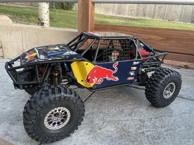

I’m getting back into the hobby after a 10 year hiatus (career+married+kids), and I ordered a Gatekeeper Kit to build over the summer as it was a great price and I wanted something easy get back in with. I would like to go brushless with this build, but I have never ran brushless in a crawler. Looking for advice on what’s an affordable reliable system that will provide low end torque crawling, but also let me open it up and catch some air.

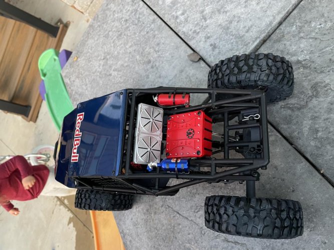

Figured I would add some pics of the build "thumbsup" working on the interior now with some 3D printed driver heads I got off Etsy :)
Any advice on gatekeepers is also welcome

Thank you! I’m really happy with how it turned out. I plan to fill in the side of cage behind the cab with a piece of styrene and a 33 for Verstappen "thumbsup"
