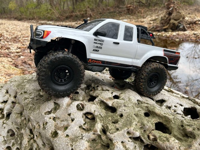

Bought new from LHS. Something bout a few scale details that really cracks open the ol wallet.

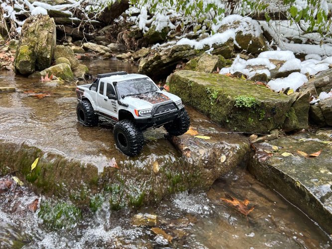

Got right to work, took it out stock stock to the creek. I think that has never been done in the history (my history) of forever.
Although it did really well stock, we all know there were some issues with cog and tires. The stock tires were not terrible, however.
Slapped a set of probuilds and swampers on it. Took it out again (stock besides wheels and tires)

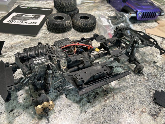

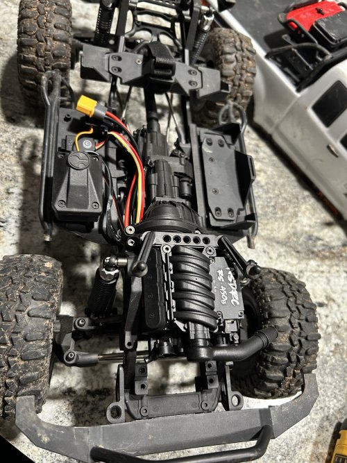

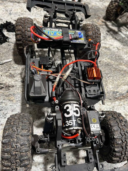

Bought the parts from a parted out cj7 chassis. New passenger side boat side (slider/ skid/ whatever you wanna call it) these have micro servo mounts for the dig and 2 speed.
Cj7 trans with dig and *surprise* 2 speed. I did not crack it open to make the 2 speed work yet as I need some micro servo mounts for that servo. Also, the lower engine pan (scale motor) and the other motor bits are all that are needed.
I first thought I’d need new shock towers, skid all that. But the basecamp skid worked just fine. It has 2 extra holes that do nothing to me that they are open. Basecamp trans- 4 mounting spots on skid/ cj7 trans- 2 trans mounts on skid and 2 on frame rails/ sliders.
Dropped right in with minimal effort
Finished attaching and straightening up some wires before it was back on the trail again.
And to top it off, I tossed in a fusion 1800kv system and nsdrc servo. Drivetrain is much gooder now with far more throttle control -IMO-than the stock brushed. All fit in like a glove.

Parts needed to 2 speed/ dig swap basecamp 10.3
Cj7 trans
Cj7 slider (passenger side only)
Lower oil pan for scale motor
Motor cover parts (intake, front motor accessories)
Shorten rear driveshaft (the two shortest pieces and short center spline is what is used)
2- micro servos
The micro-servo mount for the 2 speed servo is molded into the right side tray. There are 2 small tabs with holes in them just behind the upper line mount. The micro servo slides down in there beside the transmission with the spline facing up.

Forgot my favorite part of this trans vs the stock one, the easy motor swaps.
Two speed is officially hooked up and working. Took it out around the neighborhood to see how it did.
IMO speed difference is pretty noticeable. Maybe it’s the portals?
With low speed- it’ll pop a 1/4-half wheelie.
In high gear- it’ll pop a wheelie and ride it for a few seconds.
Top speed is very noticeable as well. My sons (10.3 basecamp with stock trans, fusion (same as mine 1800kv) on the same batteries (3s 100c) in low gear my truck is only half a truck ahead of his. In high gear my truck pulls bussessss on his lol.

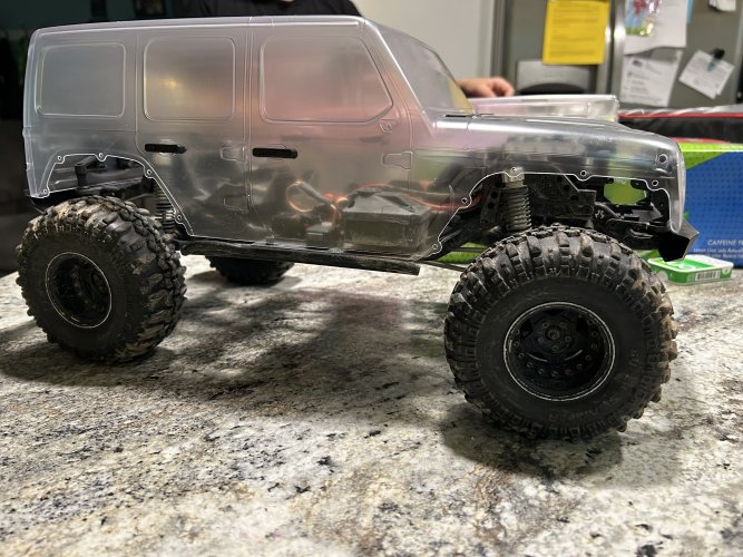

Quick little mock up.
I’m considering cutting the “hardtop” off so you can see inside, see the cage and all that good stuff. Leaving the doors as full height doors.

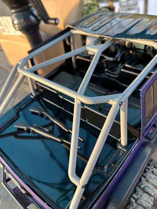

Hacked off the hard top!
My steady hand was wearing thin and patience was running out. But, it did turn out pretty good. First time I’ve ever cut a body with a knife this exact.
Pretty happy to have it all in one piece, as I could mount some magnets on the cage and reattach if wanted.

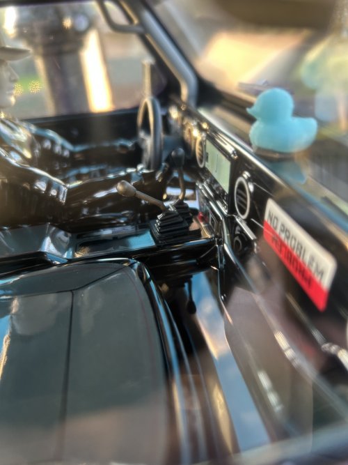

Added a manual trans
Had to also be like every other jeeper with one duck in the dash. It’s only getting one. Not a hundred 🤣
Don’t know what I’m gonna do in the bed for scale stuff but the shotgun and rifle fit well.

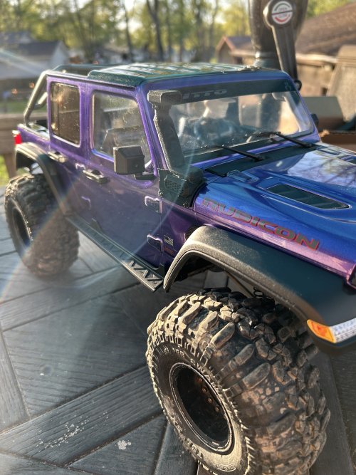

Had a leftover snorkel from my bro in laws gladiator and it fit perfect, so why not?

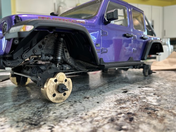

Grabbed the truck this morning and found 3 of the shocks were stuck. Had a slight hesitation when they would extend. So I took them all off and rebuilt them. New shock oil all around took care of that. Not surprised as I got the shocks used, with quite a bit of miles on them.
Also, more leftovers from my wife’s g6 build, the inner fenders. Looks much better than seeing right inside the chassis.

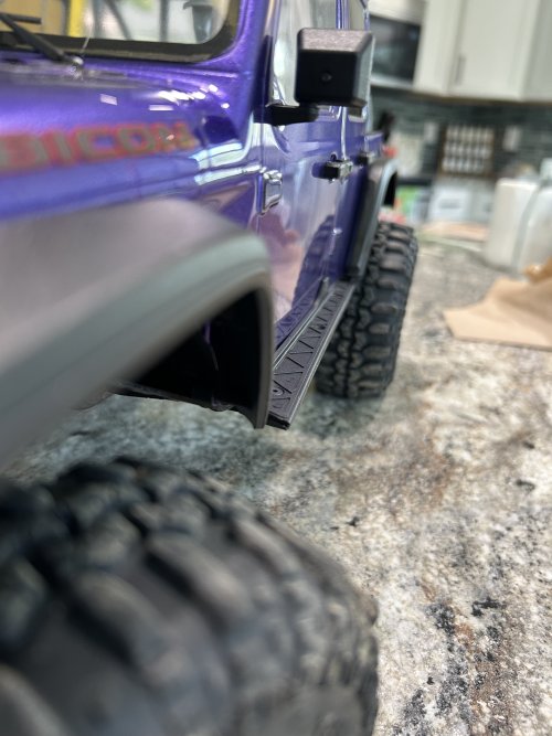

Another thing to point out. Look how goofy these sliders are for the jlu. Who thought of this?
Sticks out past the flare and to a point?! It’s gonna grab/ get stuck on every rock and branch it can. Instead of grinding them down, just went ahead and slapped the basecamp sliders back on. More clearance and less chance of it getting hung up on sliders all the time.
