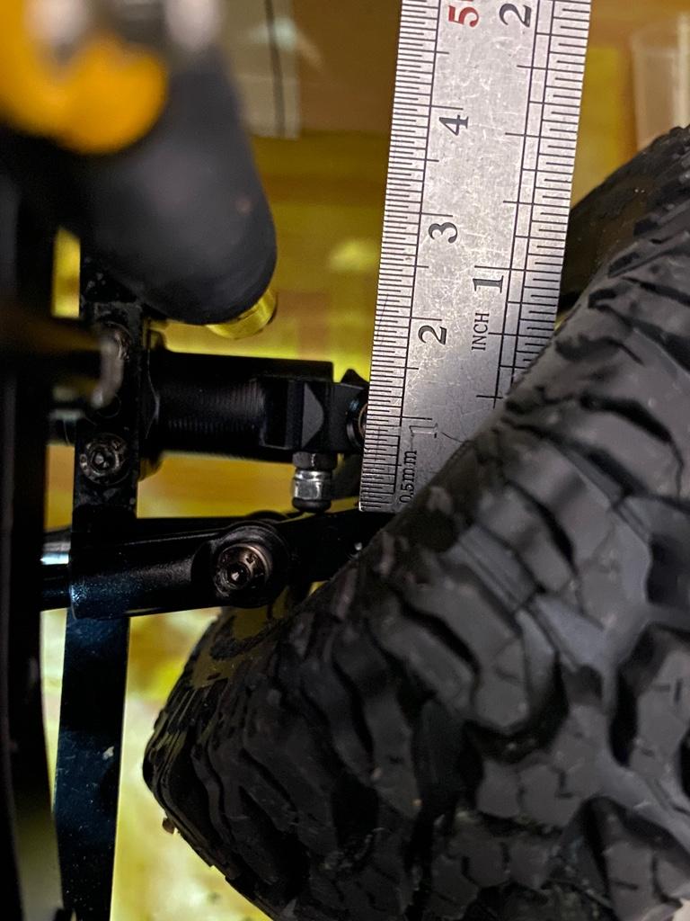

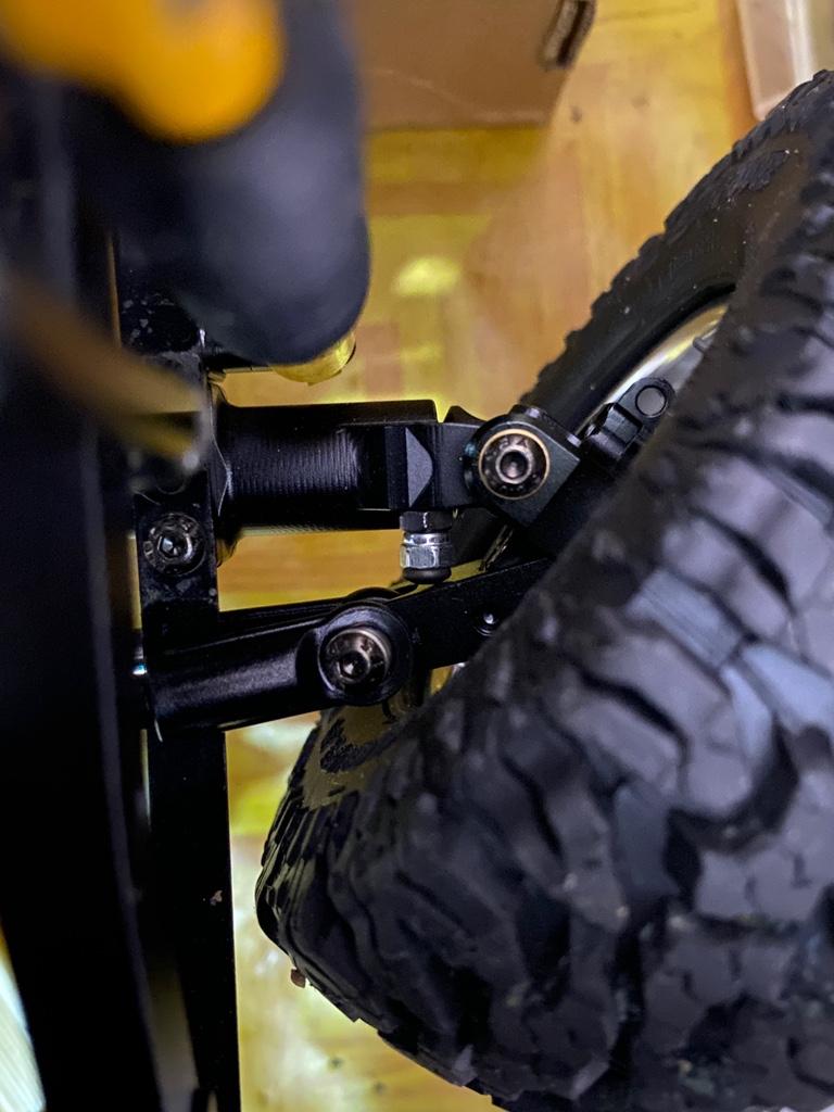

Do those boom racing axles actually steer that sharp without binding the Ujoints? If so, that's impressive. Next question, what's the max size tire you can run without all the angle allowing the tire to kiss the leaf springs?
I dont know the maximum steering of this axle, but i limit the throw with stopper that came with the axle.. i run rc4wd patagonia scale 4.1 tires that pretty wide tire for me.
