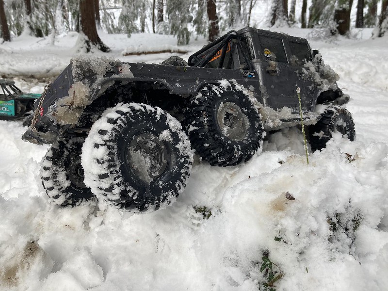

After all, it has touched the chassis, repositioning the variator, I have installed a servo winch, I have put raw builders links on the two front axles and some homemade ones on the last axis since those of raw builders were worth none. It has also been necessary to make a panhard bar since I have attached the shock absorbers to the axle, where the lower link goes instead of a little above it as it was originally, so the chassis is a few mm lower and the gap is reduced. I have advanced the turrets of the two rear axles for which the body had to be modified, and less than I thought since I have also added the standard rear bumper of the Vanquish VS4 that fits like a glove, and to put it I also advance the body about mm. and finally I have mounted the 4 shock absorbers that the previous owner gave me disassembled and it already has the 6 equal gmade shock absorbers.
