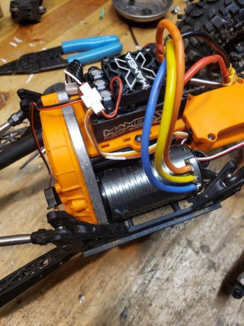

So I pulled all the electronics, even though I swore to myself I was going to leave it stock. Put in a Mamba X, a LRP 10L sensored motor and my own receiver. The motor is a 2400kv so just a bit faster but the start-up is so much better. You can walk/trail better with it now. Looking online the motor is 70mm long and it fit no problem even with the sensor cord in the back.

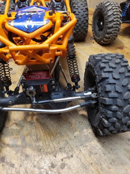

So I broke my front axle this morning on a trail run, motored up a small hill jumped it and landed on a small log. Looked really cool until I realized that I had broken my front axle. Went looking online and only found sold out every where I looked.
Had a spare AR60 sitting around so I thought I would see if it would fit. Well F-me running, it fit!! Had to adjust the link length a bit but it was really close at stock. It had stock gears in the ar60 and it gave it a underdrive in the front. Swapped out for some overdrive gears and it gives me a slight overdrive in the front axle. I did have to mount the shocks on the outside of the 4 link mount, so no more double shear.
And a bonus... if you take off the 3 screws that I have arrows to you can remove the receiver box without taking the whole thing apart, very handy.
