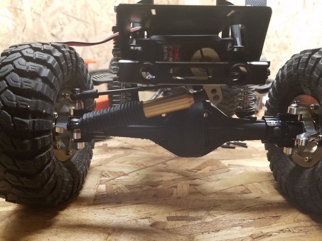

First I've made me a steering link to look like a steering stabilizer. I've used brass to add some weight above the front axle.
It looked pretty good, but it wasn't working to good.
So I had to modify it a little bit.
I've also replaced the factory axles with D60's for a more scale appearance.

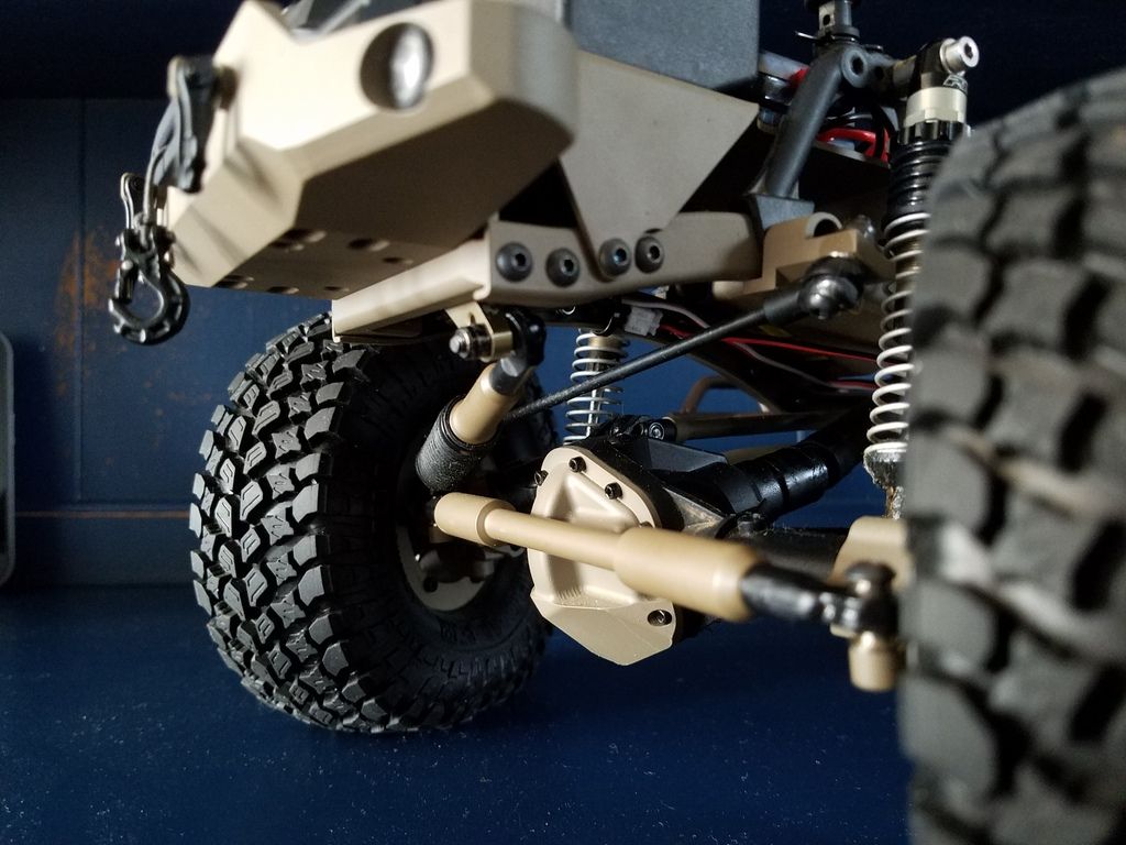

Today I've machined me a steering rod out of brass. I made it has thick (heavy) as possible, so I still have enough clearance on the SSD D60 axle and my steering link. Everything works perfectly.
I've also modified the RC Rock Armor G6 bumper to accept the Axial LED buckets, and drilled and tapped to mount some Hot Racing shackle mounts.
As you can see, I also had to remove some materiel on the bumper, to make room for my new Pit Bull Growler. Which are the largest class 2 legal tires to my understanding. They really are monsters, with 4.75" height and 1.75" wide.

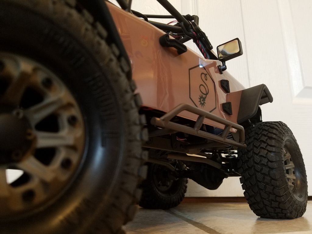

I finally had some time to keep working on my build.
I've coated all metal parts with Cerakote Firearm coating that we use in the shop. Ignore the electronics, I've ordered new ESC, Motor, and Servo.
I also had time to paint the body and to install the ob1 light kit.
After looking at it with the body and all, I have decided to widen the axles a bit. A 40 turn motor will be used to power this 9 lbs rig.
A few little things a still missing.
