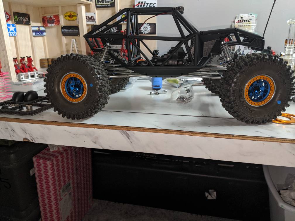

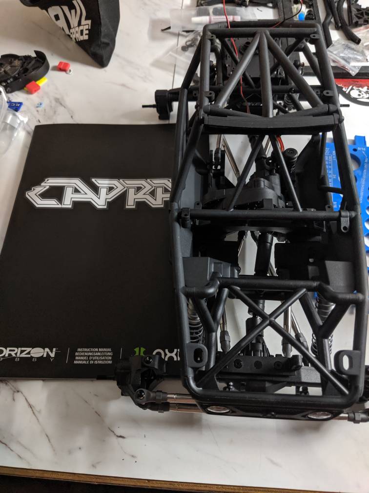

Spent enough time watching everyone else with their Enduro, 1.9 Wraith, etc... Decided to get myself a bit of fun. Picked up the kit last night. Built it immediately when I got home save for the shocks. Tossed some trx4 shocks that were laying around on it instead. Waiting on foams for the wheels and tires and for a determination to be made on the electronics. I have a tekin fxr but I sure do have fun with my brushless wraith....anyway I went back to find the manual mistakes. Got the spacer and arm figured for the dig and the cheap spektrum in place for now (going to need to swap in something else I think). I assembled the trans with the shaft inserted correctly, and the driveshafts in phase and correct length too. Going to get some inside skins from Krawler Konceptz to match the other rigs when they get the panels to build off of so paint is on hold. Planning to assemble the shocks tonight but overall im very happy with the kit. The manual should be actual size and minor issues clarified or fixed then it will be solid. The metal parts (gears and links)all felt nice and the plastic as well (the cage and the rod ends).

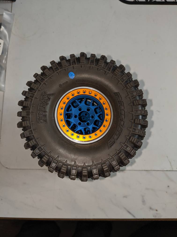

Add me to the list of folks that really dig those wheels. Are they the Vanquish KMC XD 127?
Do the Vanquish wheels clear the Portal hubs?
Yes they are.
Im waiting on CI 4.75 soft and med foams to mount them properly.
Sent from my iPhone using Tapatalk Pro
With a 225 hub these do clear. Just barely. Plenty of room if you run them with any other hub or with the xd hubcap from vp

Ok thanks for checking. To be safe I think I’ll just go with the 350.

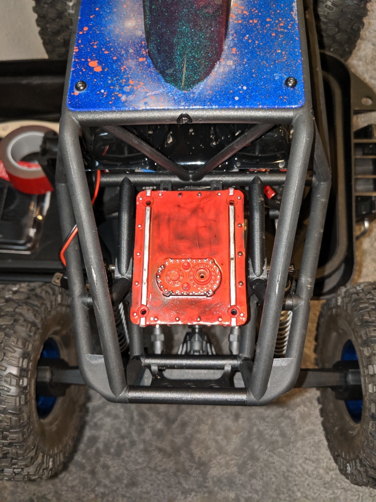

Dressed up the fuel cell a bit
