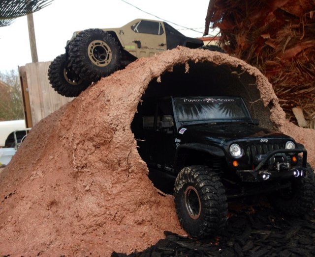

Complete for now. Plenty of things to get into and will do for now. Cool thing is that I have plenty of room on the other side of the pool for more of the same. Great little project for me and the kiddo.

I used that mix and it worked very well. We will see how it stands up to the elements. It needed less water than the 1 to 1.5 parts.. it was more like 1 to 1.25 parts. I would add the one part water then ease in the remaining until the mix was right. I will scrape the peat moss stems down after a few days of hardening, will see if a little map torch will work without discoloring it.
Several "stones" were made out of old water bottles, old magazines, some chicken wire and the mix. I need to work on the colors, I had some dye but forgot to add it in to the mix. lol. I still need to trim the inside edge of the tunnel and paint the inside.... will paint it just a few feet then throw some pea gravel on the bottom of it.
I also need to redo the "tough" end of the bridge, it is a little too steep for the JK, the AX10 can do it but it needs some rocks stacked to get it done.

FLY - we will see. I don think I will be standing on it lol. They are nice and hard, I wrapped the chicken wire pretty tight around the bottles and filled the voids with wadded paper. Worst case I will toss'em and throw some more rocks down. I just think it is cool using what would be trash to make a playground. If it holds up there will be much more of the same.
Redneck fix for the hard angle on the end. Will do for a little while.
The boy and I spent several hours playing follow the leader though, over, under and around and around. Should be good for multiple gates with a little bit of everything for my scaler. The AX10 eats just about everything up and asks for more. I will figure out some challenges for it.
