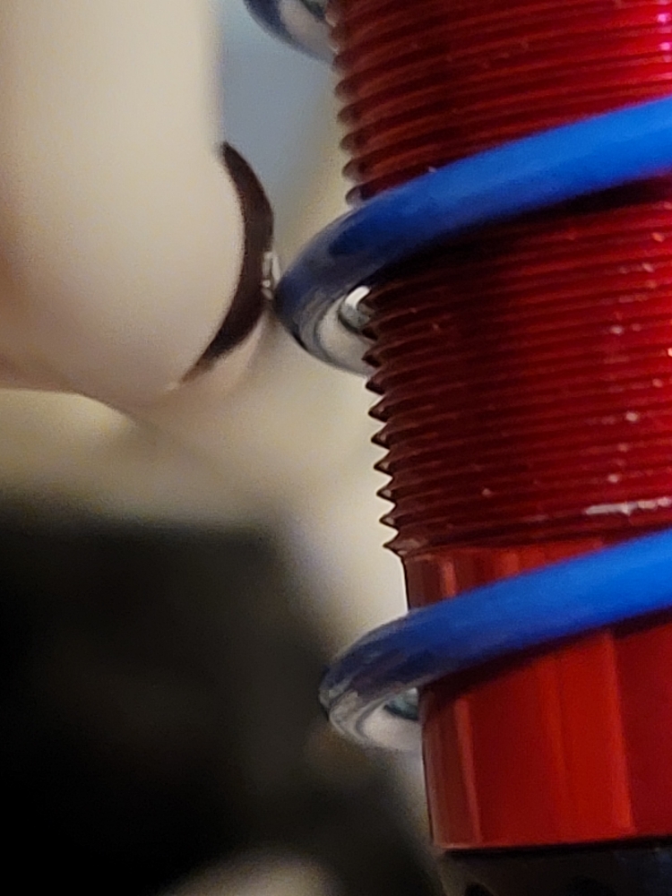

I've got some good...no, GREAT...news. Granted, it took approx 2.5 hours to come up with this, but it's WELL worth it. Instead of waiting for the LHSs to open, calling to see if they've got a display Ryft, driving over there, and playing (twice) the old "swapping shocks game", I decided to put a major percentage of my cage together, and test-fit the GTRs that got delivered on Saturday. As you can see, from the photo below, the GTRs mount perfectly...and, when I say 'perfectly', I mean it to the micron.
I mounted one shock right side up, and the other upside down, so that those interested in mounting their shocks either way will already know how well they fit. Here's a couple close-ups of both sides, where the springs just lightly touch the cage.
As you can see, with the shocks fully extended (there is NO oil in the shocks), the springs just barely touch the cage. I should note that I did NOT fully tighten the screws holding the cage together. As such, it is quite possible that the springs will actually be slightly further from the cage once all screws are properly tightened. Also of note is that, as the suspension compresses, the Springs do move slightly further away from the cage, making 'fitment' even better. With a fully-built Ryft, and battery in place, this the shocks slightly compressed, the springs will probably be 1-2mm away from the cage. On top of that, with 4mm of internal limiters (thus shortening the 'front' GTRs to the same 130mm as the stock shocks), even when fully extended, the springs will probably come no closer to the cage than 0.75-1mm.
Now, there IS a slight 'catch' to this, albeit an incredibly minor one - the GTR ball ends are narrower (by approx 2mm) than the stock ball ends, so the shocks (where attached to the axle) can slide sightly in-and-out. Honestly, I don't believe this to be a real problem, as "force" will keep them to the outside of the axle shock mounts. For those who truly want to keep the axle end of the shocks from sliding inward, you could always place M3x2mm spacers between the ball ends & inner sides of the axle's shock mounts...but, again, due to standard 'force' keeping them "out", I don't think this will be necessary.
So...there ya have it - the 134mm Traxxas GTR shocks for the UTL will, most definitely, for the front of the Ryft...and, NO modifications are needed. As for the rear end, although I didn't test them (as I'm still waiting on the longer shafts), I am 99.9% certain that will work. All you'd need are the parts mentioned in earlier posts.
