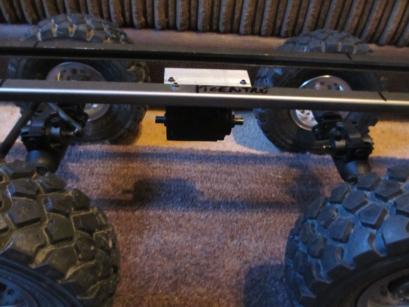

Started with 2 steel rails
Then cut out some Steel supports to mount the links
The 2 Centre Axles will get there drive from a Losi CC Gearbox that has had the Slipper removed and also the front cover which gives me a Transfer Case.
The plan is that This will attach to another LCC Trans that will send the drive to the Front Gearbox and power the Front Axle and the other ouput will transfer the drive along the Chassis rails with a Propshaft down to the Back Axle.
If my Calculations are right all the wheels should! Turn in the same directions.
Time will tell.....

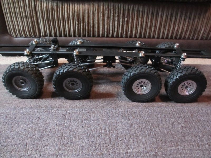

So Chassis Sorted and this is what I have come up with.
Finally got a Rolling chassis
Couple of my temporary springs are a little wonky i can adjust that later.
2 Steerers up front
