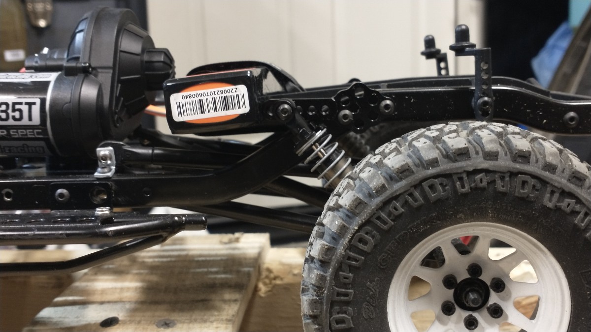

Thought I'd never update this lender truck but it's what happens when you get carried away with extra stuff. At the time of this build, I hadn't planned my 11 Toyota list yet, as this would land as #3. So this got a little more Venture-ish with installing the spare HPI parts I intended to save for my FJ Cruiser. If said FJ breaks, unsure if I'd buy the replacement part (so far most stuff still available) or swap to a different branded part (IE; tooth breaks off on one of the drivetrain gears, do Stealth X transmission swap). Onto what's been done.
- InTheWorks RC steel high clearance links (HPI to AR44).
- Austar trans went into my Tacoma double cab 10.2 build, while this received the Venture gearbox, transfer case & stock skid.
- Stock battery tray got replaced with an 80mm standoff.
- Stock rear shock mounts reinstalled.
- Spaced the motor forward from the motor mount for clearance of running smaller pinion.
- Cut the stock plastic servo mount (does not connect both shock towers anymore) to make room for rotating the motor more for proper mesh of a 12T pinion.
- Stock shocks swapped out for 10.3 straight axle shocks with white rated Axial springs (softer).
- Stock panhard mount installed and used small flat M3 bracket to rig up a panhard mount on the axle utilizing the truss as bracing.
- Inner bed received some Plastidip for that bedliner look.
- Kept the same tires on but threw on some Boom Racing Probuild wide wheels. I think these tires fit them well.
Now one thing about this setup that isn't that important because this is a lender build but still want to address it, is in the front. The driveshaft stub makes contact with the lower screw enclosing the gearbox. It prevents the front from bottoming out at about 25% less travel. I was debating on whether or not I could delete that screw and plastic mount off, but it's the only screw on the bottom half of the gear box. Maybe I can secure the housing in a different way.
