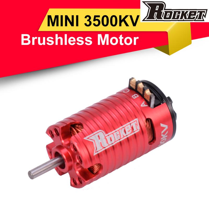

Gentlemen,
I have this brushless micro motor for my mini q.
Unhappy with the overall performance of my RC4WD blackjack. I am tempted to turn it into a higher speed mud truck.
The motor fits with plenty of room. But the shaft is 2mm. Not 1.5mm found on the Rc4wd blackjack motor.
I believe the stock pinion is 0.3 MOD. But I can not seem to fine any 0.3 MOD Pinions with a 2mm shaft. They all seem to come with 1.5mm.
What do I do? Am I not looking hard enough?
Do I have to swap my spur gear to another pitch (to match whatever 2mm pinion I do find)?
I’ve seen some of you use 130 motors or the Holmes revolvers. Both of which come with 2mm shaft.
So is there a 2mm 0.3 MOD pinion out there?
Or do I need to find a new spur gear?
Or should I just keep this motor in my mini Q touring car and look for a 1.5mm motor shaft brushless?
Any advice would be appreciated.
Thanks!

I've never seen a readily available off the shelf 0.3 mod 2.0mm bore pinion. Everyone seems to use a 1.5mm bore brass pinions and opens it up to 2mm. I've used drill bits and very small round files, but there's better ways of doing it.
I recommend an 11t pinion. The 10t seems to break when opened to 2mm

If you don't mind waiting a month you can order custom brass gears from Germany. It's not the cheapest way of doing it however.

Thank you Spoo76! I appreciate the advice.
I guess I’ll scratch this idea for now.
