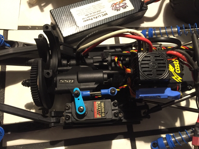

Here's how mine looks, as far as the view from the top. I had to make a shorter link to get mine to work, but it shifts standing still, and on the gas.
Made a shorter link from one of those long grub screws that the bomber uses to mount the shocks to the tube frame. I got it squared away mostly. Shifts perfect when spinning most of the time, but almost never if not spinning. Having the whole chassis together helped a lot by eliminating flex that was messing with the shifting motion. Also got my end points dialed in. It feels like it is getting better with use so maybe it just needs to break in now.
