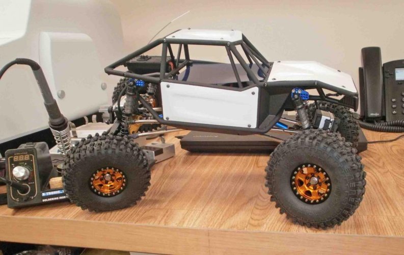

Decided to add a Capra to the collection.
Axial Capra
Custom HC skid with additional link mounting positions
Dlux Fab Hamburger transmission
Holmes Hobbies Team Spec 2250 out-runner
Castle Copperhead 10 ESC
Reefs Raw 500
In the Works custom Ti / Alum links, custom wheelbase length of 13.5"
Samix front knuck weights
SSD read cover weights
SSD OD front gears
Yota rear link riser and servo mount
Dlux Fab Drav Tech shocks
Crawling Weight: 2600 grams, 59/41 split.

Huh! And here I was thinking Capras are ugly as sin. Yours looks pretty clean.
Maybe it's the 2.2s. Or maybe your nice, simple panels and interior. Either way, nice looking buggy.
Many thanks. I have not been a big fan of Capras, but I figured it could be an interested platform if reworked. The longer rear links and 2.2's do help the curb appeal in my opinion.
s
Elimination of the stupid interior really helps!!
I put the stock interior panel in without the ridiculous helmeted dudes and while it looks so-so, yours is much better.
Now back to making an interior panel like yours like I should have done in the first place!
If it wasn't so darn tight inside, I would have considered going with it, but there is just not enough room to make adjustments with than thing in the way.
This is what I used: https://www.ebay.com/itm/7-Mesh-Cou...-Sheet-/331830916101?var=&hash=item4d42a9f405
The piece I used is 6 grams. The OEM interior was much heavier. It's just resting there, held by the cage posts. Pops in and out without needing any tools. Sorta handy.
Well, I'll get something to work. Every time I see my interior section it irritates me! It's gotta go! Yours is a much cleaner installation.
I like your alternative interior better than mine but it's at least an improvement over helmet dudes.
