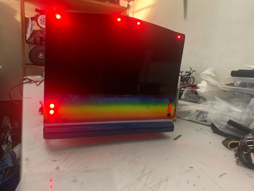

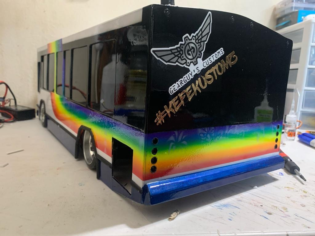

Been quiet for a minute after my crawler turned drift chassis project. Got heavier into the drifting scene & well…created this monstrosity.

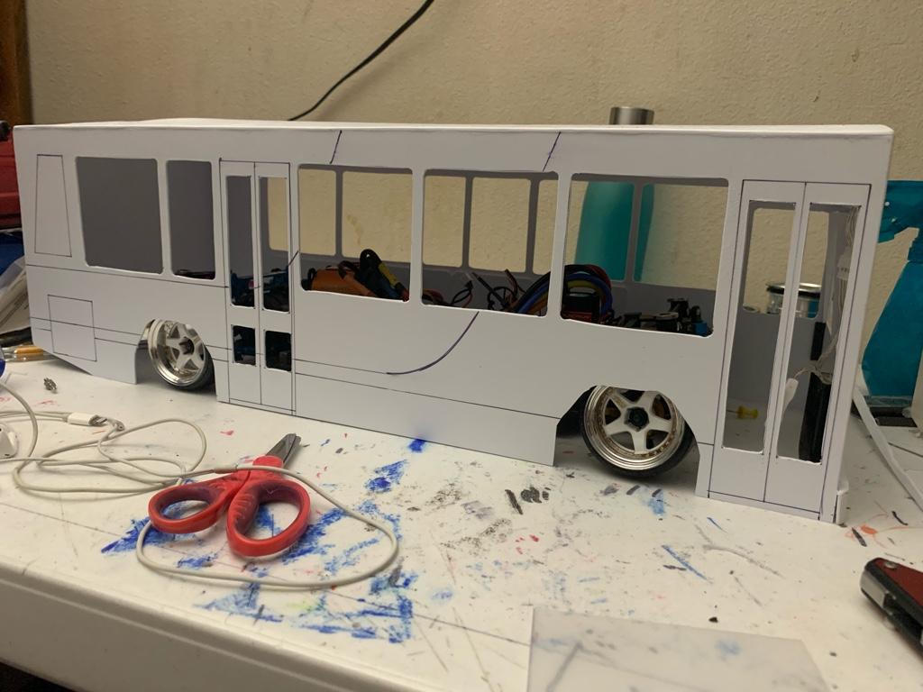

It’s a Sakura D5S RWD chassis that I’ve extended to a 12.3” wheelbase using 2 chassis bottom plates & upper decks.

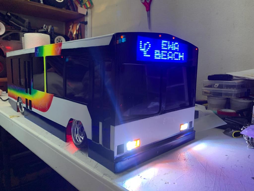

Body is all made from single pieces of 12”x24” .080 thick styrene sheet. Route sign I took from an Bluetooth LED hat, so I can customize the board to say whatever I want it to.
Lighting courtesy of MyTrickRc DG-1, running lights & their new attack wafer lights as the headlights.
Drift smoke exhaust inverted & stuck thru the roof.
Windows are clear PET sheets I picked up off Amazon & tinted using VHT Niteshades.

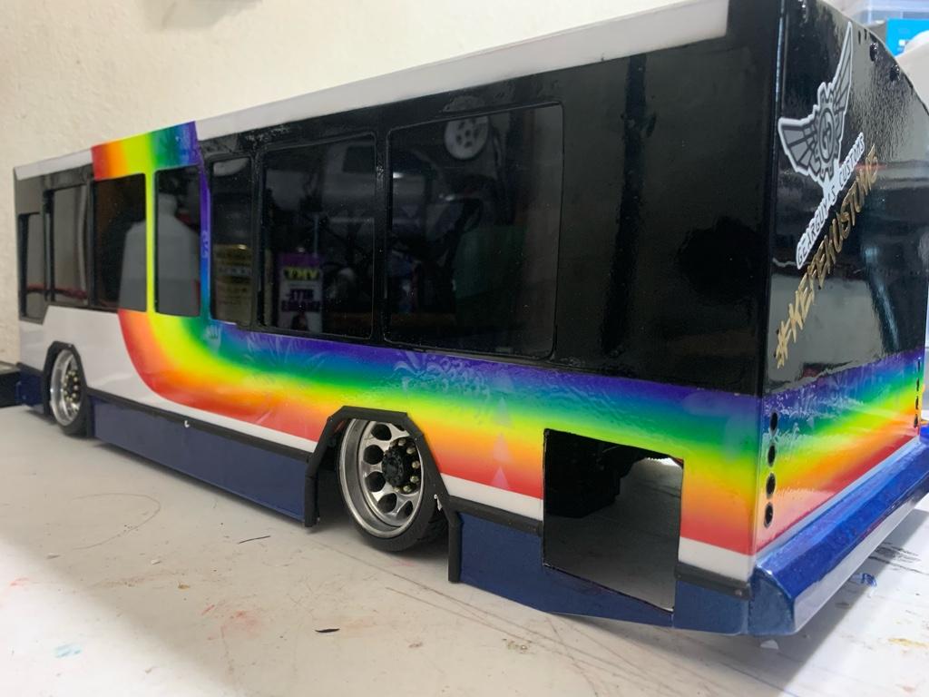

Wheels are custom 3D printed except the front barrels which are MST adjustable offset barrels. Wheels themselves are 1.9 replicas of the HPI classic king with a dually twist to it with the center caps & convex front wheel & concave rears.
Shocks are mounted on servos for that “bagged” effect when hard parked.
She’s heavy, but she handles incredibly for what it is.

This bus is “bagged” essentially. Hahaha. I have both front & rear shocks on servos to lay the body on the ground & tuck wheels.
I actually have added some scale stickers like the handicap, “TheBus”, the www.TheBus.org & a modified “This bus makes wide right turns” that reads as “This bus makes WIDE ASS turns” with a pic of the bus turning both left & right [emoji23][emoji1787]
Motor access panel/vent on the rear driver side has been since covered with window screen like originally planned. Hahahaha
I was gonna do an interior, but considering how heavy it is already, I opted out to still be able to drift. Although the body roll in corner entry & exit is a killah sight to see. [emoji23][emoji1787]
This is one of those projects that’ll never be done cuz of all the possible small details that can be added.
Actually bought a Keanu Reeves doll to repaint as his “Speed” character & either hang him out the driver window or have him being dragged on a creeper cart from behind the bus. Hahahaha
As for the doors, it was in the planning & still is. Hahaha. Just been busy with my SixtyFour Yota mini truck. Hahahaha
