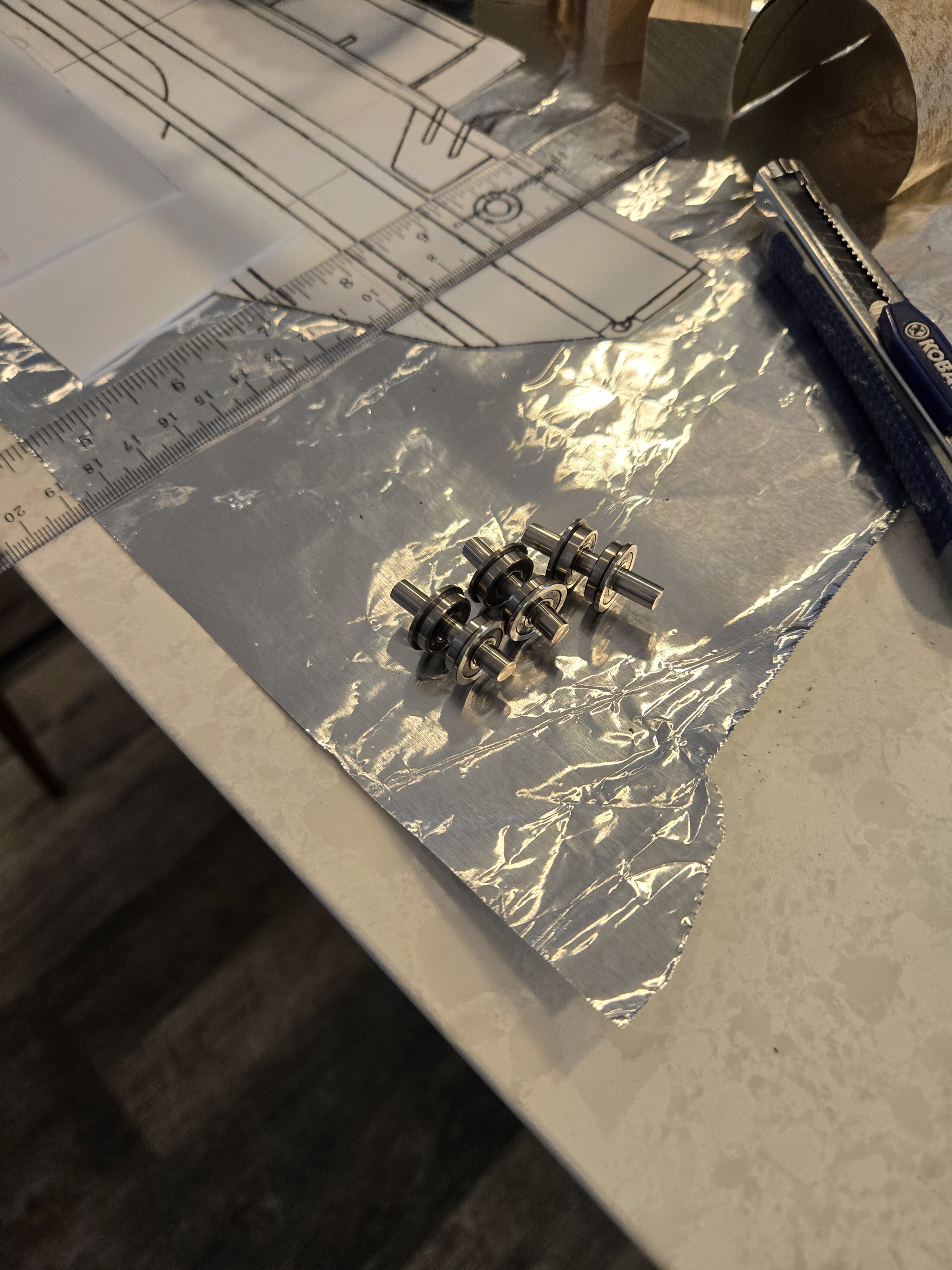

My solution to waterproofing the 3 driveshafts going from transfer case to axles. I made 3 very short shafts running through dual sealed bearings to pass through the hull
