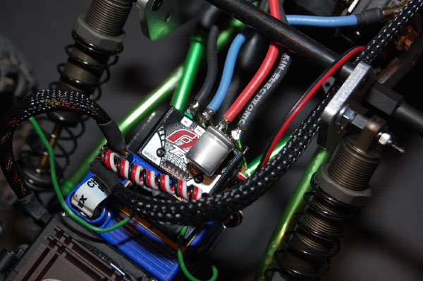

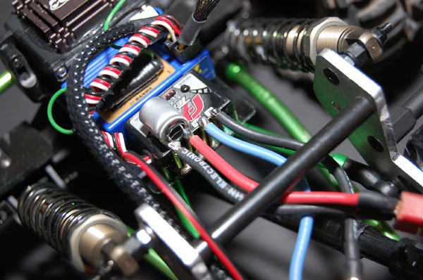

Well I finally got a chance to install and test the Tekin FX-R. As you know from a previous post (see below) I have been looking for the ultimate ESC. Here are my requirements:
- Size (anything smaller than the Mamba Max or Novak Rooster)
- 6.0V/3Amp BEC
- Drag Brake
- Brushed specific
- User Programmable
- 3 Cell LiPo Capable
I know that there are several ESC's out there that will fit most of this list of requirements but not all. So let’s see how the Tekin FX-R stacks up.
Size/Weight
Dimensions: 1.1 x 0.80 x 0.40 " (28 x 20 x 10mm)
Weight: 1.1oz.
When I first laid eyes on the FX-R I could not believe how small it was. At only 1.1 x 0.80 x 0.40 its the smallest ESC in it's class and is so much lighter than anything else that I've used. In the images below you can see how much smaller it is compared to the Airtronics Micro Receiver. As you know, our competition crawlers are getting more and more difficult to find room for the electronics and this ESC fits the bill perfectly. A guy could strap this thing to the side of his shock it's so small.
The weight of the ESC is a huge bonus too. In the past I've tried to place the ESC as low as possible to reduce CG. With this ESC there is really no need. It's so light that you won't notice its placement much at all. And if you use an Axial axle you can mount the esc on the front or rear axle with The Crawler Stores electronics trays.
Simply put....It weights nothing and has the footprint of a nat. This fits my requirements perfectly.
BEC
6.0V/3Amps
This is a perfect setup for a 2.2 comp rig. No external voltage regulators needed but if a guy wanted to boost it to 5 amps or more the option is there with a Novak or Castle Creations BEC. There simple to use and provide tons of voltage bliss for your servos.
The Tekin FX-R works perfectly for my BEC needs.
Drag Brake
I can't tell you how many times I've been shown up by some brushless crawler in a competition rolling downhill like it was being winched down. No matter how smooth or tuned my reverse is on my ESC's of the past, they never work the way I want them too. I either end up rolling downhill so fast that I hit the gate or blow right past it off some bloody cliff. During the last competition I decided that I was going to run nothing at all if I didn't find an ESC with drag brake.
The Tekin FX-R is PERFECT as far as drag brake is concerned. It has 11 steps to choose from in the field and as many as your heart desires with the Hotwire. Finally an ESC with drag brake for a brushed motor made by a company that specializes in brushed motors. I have yet to find an ESC that does a better job here. If you have never ran an ESC with drag brake you are missing out. And if your not running the Tekin ESC's with drag brake you’re not getting the most of your crawler. There is no way now that I have run drag brake that I will ever run without it.
Needless to say the Tekin FX-R is spot on with the drag brake feature.
Brushed Specific
Why? Simple, I can't stand brushless systems. It's my personal opinion but brushed motors are smoother and have a better more controllable feel to them. I've ran dozens of different brushless systems and the only systems that feel as good or close to a brushed motor is a censored setup and there too big and bulky for my taste.
I also wanted my ESC built by a company that specialized in brushed motors. I'm not sure if it matters but I do know this. There are 2 manufactures out there making brushed ESC's that have more time doing this than any other company. Novak and Tekin. There brushed systems are amazing, so I figure why not go with a brushed ESC from one of the best.
Tekin once again is perfect for this category.
User Programmable
I really like being able to tune my ESC to my particular needs, and being able to do so without needing a PC is an added bonus. Tekin has the following field tunable specs:
Drag Brake (11 steps)
Neutral Width (11 Steps)
Current Limiter (none, 10 steps)
Push Control- Anti Drag (11 steps)
FX, FXPro: Throttle Profiles (6 choices)
FX, FXPro: Brake Profiles (6 choices)
FX-R,FX-R Pro: Reverse Type (3 choices)
FX-R,FX-R Pro: Reverse Strength (11 steps)
Voltage Cutoffs (none, 2S, 3S, Custom)
The program is very easy to work. I especially dig the drag brake setting, reverse type, reverse strength and voltage cutoff. I can't wait to get the Hotwire and dig around in the ESC
The Tekin FX-R works great here.
3 Cell LiPo Capable
I have been watching rigs now in competition jump gaps, shoot vertical walls, and power out of some nasty situations. I made the decision after talking with the guys at MaxAmps to run a 3 Cell LiPo and LOVE IT! I run a 55x1 and I have plenty of wheel speed. It has made crawling so much more fun being able to shoot gaps and hit vertical lines that I could not have done before. It's a total riot and the guys are MaxAmps have got some great battery choices. I've been using them now for over a year and couldn't be happier.
Tekin hit the mark again!
Another feature of the Tekin FX-R that I really dig is the solder posts. Tekin has done this for years and I can't tell you how many times I've had to crack open an ESC to replace the dang wires. I re-use ESC's for all my rigs and placement always changes from rig to rig. Having the ability to replace the wires is a huge plus for me. It's clean, simple and easy to do.
Cost
It's not the cheapest ESC but it's not the most expensive either. It's about $100 - $125 give or take. Perfect for a competition rig.
Conclusion - Tekin hit every need that I was hunting for and more. The FX-R in my opinion is the finest ESC for 2.2 competition or Scale use out there. Every ESC in my collection is going to be replaced by one of these and can't thank Tekin enough for there great products. My only regret is that I didn't look into Tekin earlier.
I hope this helps everyone out and if you have any questions, don't hesitate to ask.
Thanks for reading!
