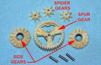

Let's briefly walk through some half dozen ways to lock a Clod differential. This assembly consists of the differential spur gear, three spider gears, two side gears, and the three pins that hold the spider gears in the spur gear. What we want to do is ‘lock' the two side gears to the spur gear, and effectively to each other. This will lock both wheels on the axle together.

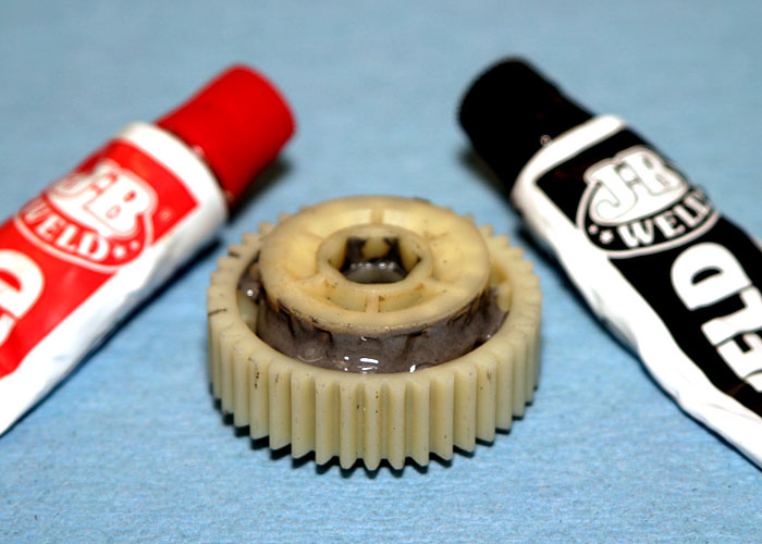

(3)  JB WELD – This 2-part fix-it repair compound may be about the strongest way to glue your Clod differential. As with all the glue methods, more glue may be better, it just adds more weight to the assembly.
Pros: inexpensive, strong glue method
Cons: must be careful applying epoxy, stock hex sockets in side gears may strip and fail under hard use

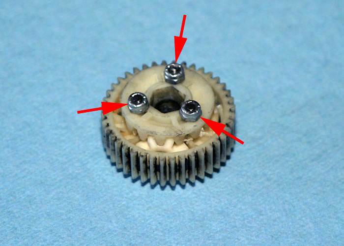

(4)  SCREWS – This method involves using three machine screws & nuts to bolt the two side gears together, stopping the spider gears from moving inside. The trick here is keeping everything straight and cleaning the debris off the gears before reassembly.
Pros: cheap
Cons: somewhat tricky assembly, stock hex sockets may fail under hard use

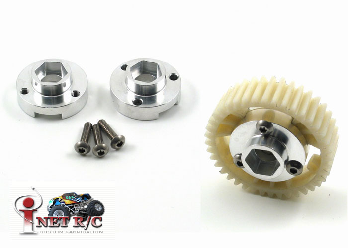

(5)  SPIDER GEAR REPLACEMENT – Several aftermarket suppliers manufacture a set of delrin or aluminum pieces that screw together and sandwich the spur gear. These pieces replace the stock side gears and spider gears to form a locked assembly.
Sources: InetRC, The Crawler Store, Thundertech Racing ~$23
Pros: quick installation, reversible to stock, stronger hex socket
Cons: higher cost than homebrew methods
